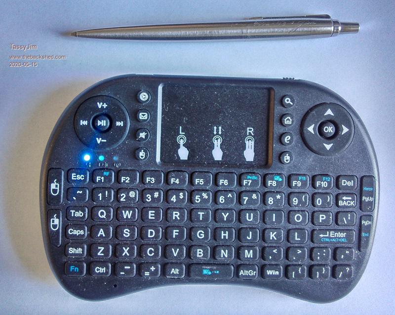

Posts: 6643
Posted: 11:11pm 14 May 2020
I was shocked to find that this one does work.
It's a heap of doggy-do so wouldn't recommend it but it does work - not the mouse part.
Edited 2020-05-15 09:12 by TassyJim
