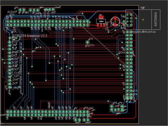

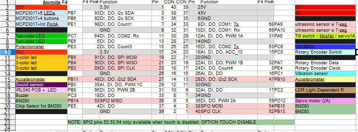

This PCB provides a a 2x20 expansion port like that on the CMM2. Pin functions are similar to the CMM2 (though the F4 doesn't have as many analog pins available).

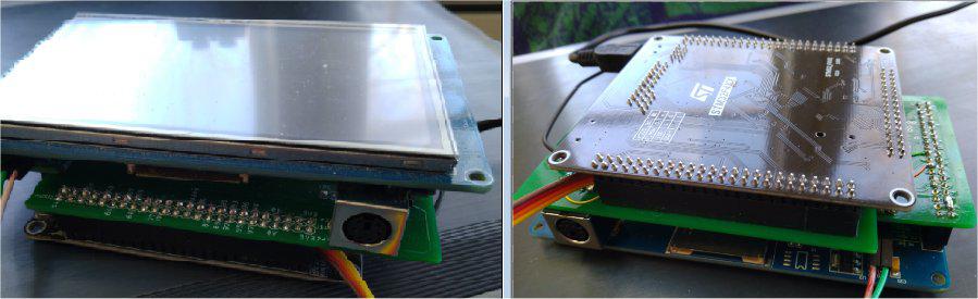

Here it is with an SSD1963 plugged in:
With this, the F4 can have the recently posted 2x20 breakout PCB plugged in, as well as other 2x20 PCBs and flying wired modules.
Keyboard and ESP-01 (on Com3) are also supported, as is Com4.
An ILI9341 TFT LCD is supported. Backlight adjustment is not supported--use of a backlight resistor 18-Ohm to 47-Ohm is available. (Of course, 16-bit 32-pin LCDs can also be used, as can 34-pin IPS_4_16 (with adaptor) and SSD1963 (with one or 2 adaptors)).

Zipped GERBER files are attached. These can be sent directly to JLCPCB.
EagleCad files are also attached.
F4_04_pc_2021-04-11.zip
F4_04_PC_V2.zip
I'm afraid the EagleCad files are a mess. The schematic file is because I didn't have an F4 footprint, so I made do with 4 24-pin SIL connectors (I've never made an EagleCad component, but would probably have saved time in the long run and made a better job of it if I had). With the .brd file, I at some point made a group move which shifted things off of the tenth-inch grid, so a lot of the traces are funky.
I've made a number of changes since the first version which I tested, so there could still be some glitches.
