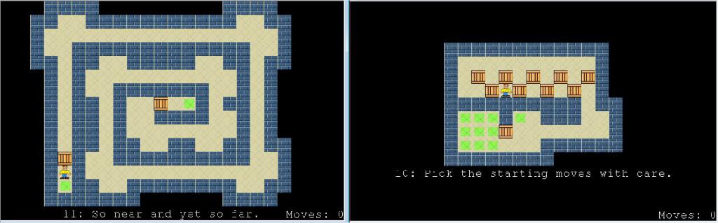

Here's my latest diversion:
Many should recognize this as a clone of a particular pushing game with a Japanese name. However, everything in my version is my own creation and should be copyright safe.
The game has 12 levels built in to get you started. Many more levels can be found on the internet by searching for "Sokoban levels". Make sure you use txt formatted levels.

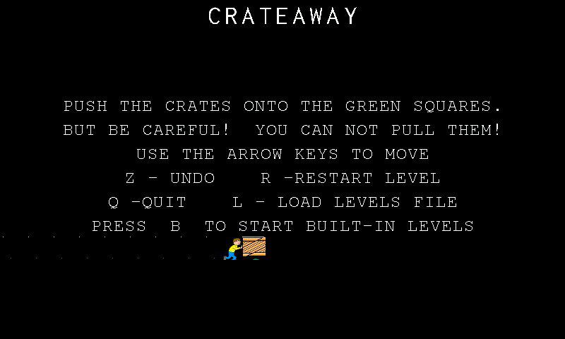

' Use the arrow keys to move
' Z - undo
' R - restart level
' Q - quit
' B - play built-in levels
' L - load levels file
' N - 'undocumented' skip to next level

Should be no firmware requirements.
You could just add more data lines. No program change required.
But better would be to put them in a separate text file. Then they are easily shared.
Save this as a text file and it can be played. (Not much challenge though.)

Game starts now with button B,
only Button "R" for restarting level gives "Error in line 168: Syntax", all other buttons work well.
Very good work and nice graphics!!!
