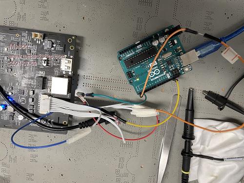

Solar energy is the energy generated by the continuous nuclear fusion reaction process inside the sun, while solar power generation panel is the tool to convert solar energy into electricity. During the conversion process, we generally focus on the following parameters:
A. Output voltage of solar panels
B. The output voltage of the circuit protection device, that is, the real output voltage of the output terminal
C. Conversion efficiency
According to the above information, we can use the UART touch screen of STONE to make a human-machine interface to display the power generation of solar panels and charging of lithium batteries in real-time.
The HMI display is as follows
1. Display the power generation voltage of the solar charging panel through the STONE display module
2. Display lithium battery voltage through the STONE display module
3. The charging efficiency is shown by the STONE display module
In practical application, there may be more parameters to pay attention to, but since I am not from this major, I only pay attention to the above three parameters.
The hardware modules that I have:
1. Solar charging panel
2. STONE serial touch screen
3. Arduino UNO
4. Lithium battery charging board
5. Lithium battery

Now I have learned how to connect the Arduino to the display.
Does anyone perhaps have a good suggestion about solar charging or how to put them together?
What all do I need to look for in this process?

The output voltage of the charger must never exceed the maximum charging voltage of the battery and the output current of the charger must never exceed the maximum charging current of the battery. Those are fixed limits, it doesn't matter what your solar panel generates - anything exceeding these limits has to be throttled back in some way. That has nothing to do with charging efficiency.
If you are looking for efficiency calculations then you are looking at Watts generated and Watts feeding the battery. Between these is the charger module - and it is that which you are calculating the efficiency of. You can't calculate the efficiency of the solar panel without knowing the light intensity and Watts output. You can't calculate the efficiency of the battery as you (apparently) aren't measuring its output into a known load.
There are two sorts of charger modules.
.  A switching type accepts a wide range of input voltages from the solar panel and generates a charging output for the battery by using PWM techniques to reduce losses. The output remains more or less constant while the panel is illuminated.
.  A linear type (much cheaper) does almost the same thing but all excess power from the panel is dissipated in the charger module as heat. Obviously, this heat is the loss of efficiency.
You'll notice that I've been referring to Watts. That's what you need to get your calculations as the output voltage and current from the panel may not be the same as the input voltage and current to the battery - depending on the type and efficiency of the charger module. To get Watts you will need to measure current in both positions as well as voltage. I would suggest getting high-side current sensors to simplify things. Your Arduino will then have analogue inputs for voltage and current on both sides of the charger. After that it's up to you. :)

Efficiency of the solar panel is maximized by constantly adjusting the switching regulator to keep the panel at it's optimum combination of voltage and current, for the solar intensity. The switcher is doing double duty as a charger and peak power tracker.
The efficiency of the batteries is related to the difference between charging and discharging voltages. There isn't much you can do to change it.

I'm not sure that Mason is using a proper solar charger board, Phil. The (Russian) page in his link is only to generic lithuim cell chargers as far as I can see (I can't read it but I recognise several of the boards). Not the best way to do it.
