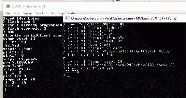

Posts: 3707
Posted: 11:46pm 27 Feb 2022
The addition of the EXECUTE command makes a Picomite serial client almost trivial. All regular basic I/O-related commands can simply be sent over serial and EXECUTEd. The only commands which need special handling are those which return values: DIN, AIN, CIN, FIN, PIN, TEMPR.
' serialClient.bas acts on serial messages
' if first character is "!", text data is to be returned, CR terminate
'   otherwise, single command is to be run with "EXECUTE"
OPTION AUTORUN ON
dim integer msg(3)
dim string cmd
pause 2000
print "Picomite SerialClient starting"
SetPin 22,21,com1 ' setpin 21,uart0tx:SetPin 22,uart0rx
open "com1:115200, 256, SerInt, 4" As #1 ' interrupt triggered with 4 characters
DO ' the program loops forever
WATCHDOG 2000 ' this will recover from errors
LOOP
SUB SerInt ' received a message
msg(0)=asc(input$(1,#1))
if chr$(msg(0)) <> "!" then
  pause 30 ' allow all characters in command to arrive
  line input #1,cmd
  cmd=chr$(msg(0))+cmd ' input$(255, #1)
  print cmd
  EXECUTE cmd
else ' function call will return data
  msg(0)=asc(input$(1,#1)): msg(1)=asc(input$(1,#1)): msg(2)=asc(input$(1,#1))
  print msg(0);" ";msg(1);" ";msg(2);" "
  if msg(0) = 3 then ' the command must be 3
    if msg(2) = 10 then ' DS18B20
'        s$ = mid$(str$(tempr(pin(msg(1)),3,3) + Space$(12),1,12) ' get the temperature
      s$ = str$(tempr(pin(msg(1))),3,3) ' get the input on the I/O pin
      print s$
    else ' value of DIN, AIN, CIN, FIN, PIN pin
'        s$ = mid$(str$(pin(msg(1))) + Space$(12),1,12) ' get the input on the I/O pin
      s$ = str$(pin(msg(1))) ' get the input on the I/O pin
  print "pin(";msg(1);"): "+s$
    endif
    print #1,s$
  ENDIF
ENDIF
do while loc(1)>0: cmd=input$(255,#1): loop ' flush the input buffer
END SUB ' return from the interrupt
This is run from MMB4W.
Not implemented, but EXECUTE "GOSUB somewhere" would be very valuable.
For the commands which return a value, 3-byte sequences (plus CR) are sent (following Geoff's I2C protocol), but using only the binary 3 value for the first byte to indicate that a return value is expected. The pin number in binary form is the second byte, and the third byte is "don't care" except that for the DS18B20 the value must be 10. These 3-byte function-type commands are preceded by "!"--anything that does not have this lead character is sent straight to EXECUTE.
This simple program provides pretty good I/O for a PC running MMB4W or MMBasic DOS or a device running MMB4L. The code is easily expanded to provide more features as required.
Picomite on FruitOfTheShed
Edited 2022-02-28 13:21 by lizby
