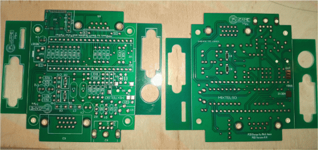

Question: are the end panels supposed to snap off or do I need to cut them (I have a bandsaw)?

I couldn't get them to be snap-off for a couple of reasons. If you mark something as snap-off it's charged as an extra board unless it's identical to the rest, so that would have been the cost of three boards. Also, for snap off designs you have to leave waste areas that are big enough for the clamps and I've used virtually all of the available area for a cheap board.
A bandsaw would be lovely but I've not got one. I do have a sharp craft knife and a 4in vice though. :)
From the doc:
  Quote  The PCB is supplied with the front and back case panels attached. It is, of course, necessary to cut these off. I find that the best way is to put a panel part into a vice (I use some pieces of aluminium angle in the jaws to give some protection as you need to grip it quite tightly), with the top of the jaws along the cutting line. Then score several times with a sharp craft knife on both sides, using the top of the jaws as a guide. I then push the pcb over using a piece of wood and it will snap along the scored line. Clean up both edges with a file (Warning! Fibreglass particles are an irritant - at least wear a dust mask!) then do the other side.
(This is the bit that makes me apprehensive, when one of my designs gets built for the first time and someone else is the guinea pig! Some things, like the cut-outs for the sockets, are not easy to sort out in SL6. I can draw them in CAD, but SL6 can't import any sort of CAD files. It is missing simple tools that would make it even a half-reasonable general purpose CAD.)

They are drawn on layer O firstly as a rectangle. Although it doesn't matter much on a big slot, you have to bear in mind that they will be cut out with a router so the corners will be radiused. You can get rounded corners by putting quadrants into them then drawing over the rectangle to join the quadrants. Then you can delete the original rectangle.
Anything drawn on layer O will be cut. I also indicate that it's a cutout by drawing a simple cross roughly in the centre of each.
You can make circular holes by putting a pad on layer O with the inside and outside diameters the same. Small slots are done by overlapping several of these together, in theory, but it's something I've not tried yet.
Mechanical work in SL6 leaves a little to be desired.  :)

Craft knife and PCB in vice would probably make a cleaner cut. I probably won't be putting it a box though--nothing else I have is in a box. Even my CMM2 has always had the top off. I do appreciate the fact that you make them to fit a box, though.

Mick very generously sent me one of these, which I have successfully built & yes a craft knife & a vice worked very well, though you do need to really work at it with the knife, before it'll snap off nicely.

On the later boards I'm removing the ground plane copper from both sides of the end plates. It eases the fitting a little and should make the boards easier to score as, at worst, only the very edge of the copper will be being cut. It'll reduce the strength a little, but as the panel is completely gripped by the vice jaws (and I've arranged the panels to have maximum width at the cut line) I don't think there'll be a problem.
