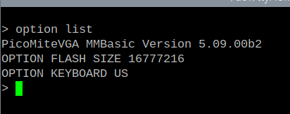

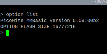

Hi All;
I am working with the Waveshare RP2040-Plus which some of you might be familiar with.
It has battery connector, USB-C console connector, reset and boot buttons, lastly it has 16 meg flash onboard.
It is likely that I don't know what I am doing, however,when I install 5.9.0b2 any version that has USB or VGAUSB in the name, does not allow me to access the RP2040 via the console to setup options. The other versions work as expected
As I have no other boards other than PICO-Ws to test with I don't know if the problem is confined to this Waveshare board or my understanding of how this new version works.
Thanks for any comments you may have.
Hans ...
Posts: 2807
Posted: 11:59pm 24 Feb 2024
usb lcd and vga seem to install ok but console needs setting speed 115200 and you get ">" if that's what you mean :) stan
Hans
Joined: 18/10/2022
Posts: 117
Posted: 12:06am 25 Feb 2024
  stanleyella said  usb lcd and vga seem to install ok but console needs setting speed 115200 and you get ">" if that's what you mean :) stan
115200 is set in putty to be my default speed. Same result no connection.

I am starting to wonder if these versions will only run on the board that Peter was proposing?
The following are screen shots of the PicoMite and PicoMiteVGA loaded on to the same Waveshare board I was trying to load the USB and VGAUSB versions.
Hans ...
