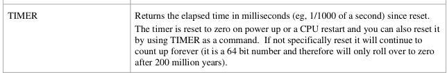

bfwolf
Joined: 03/01/2025
Posts: 258
Posted: 09:22am 03 Mar 2025
I'm also "a little bit confused"..
From the latest manual:
> list
Option explicit
Dim i As integer, t As float
Timer = 0
t = Timer
Print Timer, t, Format$(t, "%08.3f")
For i=0 To 1000000
Next i
t = Timer
End
> run
0.049   0.022  0000.022
6577.698        6577.677       6577.677
@Geoff, @Peter:
Could it be, that "Timer" gives milliseconds with microseconds (3 digits after the dot) resolution?
> option list
PicoMite MMBasic RP2350A Edition V6.00.02b15
OPTION FLASH SIZE 4194304
OPTION COLOURCODE ON
OPTION CPUSPEED  150000 'KHz
