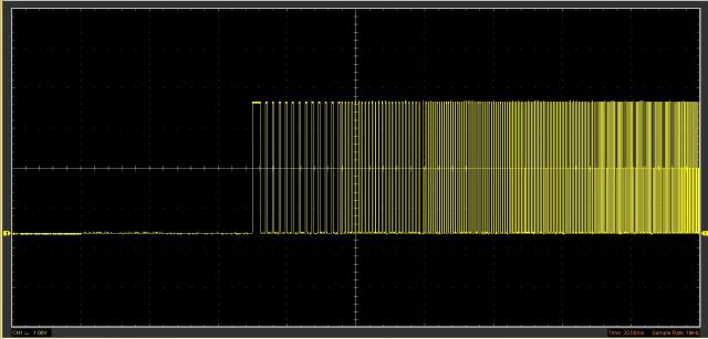

Running "Range20To1000", here's the waveform ... (Remember, this is using Beta 7)
If you comment in and out the various calls to the subs, you'll see there's a variation on the same theme - The worst offender is the "Range20To100".
...So, I loaded the code I had running a few days ago, and it certainly wasn't happy either. A very jumpy motor tone and seemed to be running a higher temperature on the motor. I went for a bite to eat and a think and when I came back the motor was sitting on the pad 45 degrees angle to what I left it at, which tells me that there's some serious stepping glitches happening (the momentum of the pulling up a motor makes a tiny jump)

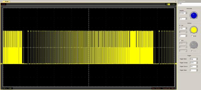

So...... back in with Beta 6 and here's the "Range20To1000" code again.
It's hard to see, but the first picture is a 50m/s timebase and the second is 100m/s timebase yet running the same code.

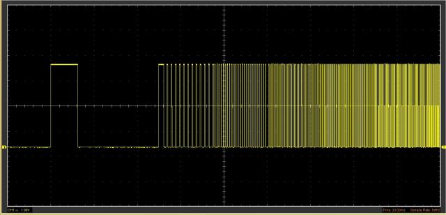

Here's the B6 waveform
The first wide pulse is 2.9mS wide and MAY be a remnant of the 20Hz PWM, but I can't be sure. Each change in errr... 'texture' (where the frequency changes and so the colour changes) corresponds to the 50mS pause value and the frequencies increase by the step value. All good there...
Here's B7 waveform running the same code
Again, the first 2 pulses are probably the 20Hz remnants and the same 'pattern' in both waveform recordings. Also shown is the gap in the 1250Hz
