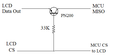

Posted: 07:58am 01 Sep 2022
"Can confirm both touch and SDcard working with a 680ohm resistor in the MISO line from the LCD. LCD then also works with BLIT, PIXEL() and transparent text."
On my ILI9488 / PicoMite SD access has been a bit hit and miss so I have replaced the 680R with this circuit - from earlier in this thread. The PNP transistor only switches LCD_SO on when LCD_CS is low, so there is no load on the SD card output.
Now every SD card works all the time along with pixel(x,y), BLIT and SAVE IMAGE as well as touch.
PS. It still works if you swap collector and emitter. The PN200 has enough gain in the reverse direction and 3.3V is way too low to cause B-E reverse breakdown.
Measured a PN200
Forward current gain = 430
Reverse current gain = 29
With 3.3V and 33k base resistor the reverse current is up to 2.4 mA so fast push-pull drive of MISO is no problem.
If using a different transistor a lower value base resistor may be needed. Perhaps also a pullup from MCU MISO to 3V3 with a value 5 to 10 times the base resistor.

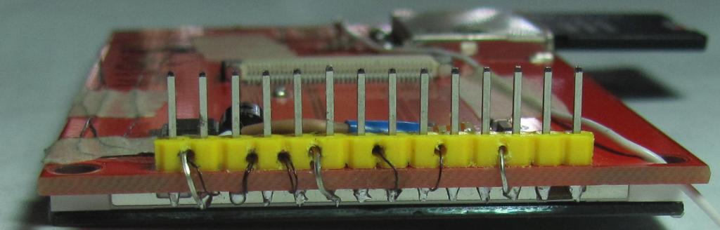

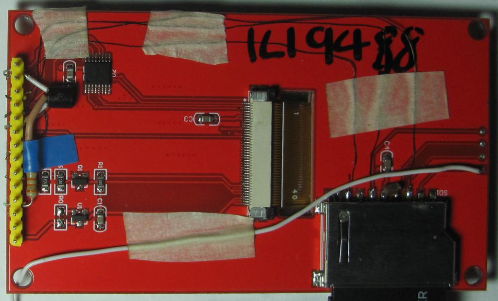

Mounted it on the back of the display, along with the rest of the SPI wiring for touch and SD card. Pico SPI wires now only go to the touch pins.

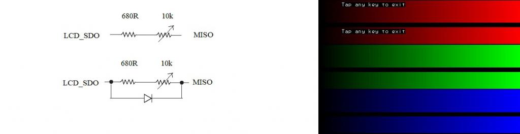

To improve SD card reliability without adding a transistor it may be enough just to increase the 680R.
This test will allow you to see how high it can be before reading back from your display fails. Adjust the pot while watching the Blit stripes for colour changes.
If that still isn't enough you may be able to get it higher by putting a diode across the resistor as fast rising edges seem to be important.
The chip fault holds SDO low so the anode goes to SDO, cathode to MISO.
However the improvement still didn't allow all my SD cards to work all the time.

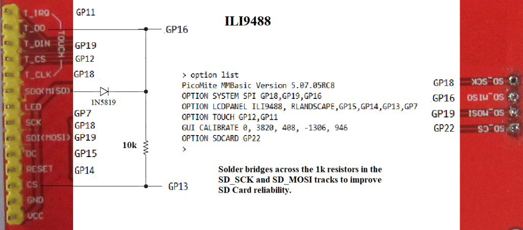

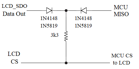

Another way to get everything working properly is with a diode switch.
This has been tested with resistor values from 1k8 to 10k.
Had intended to add a pullup from MCU MISO to 3V3 with a value 5 to 10 times the CS resistor, but found it wasn't needed. Replacing the right hand diode such a resistor might also work.
This was found when @DrifterNL tried a BC558 and it didn't work. He reduced the base resistor until it did at 2k2. With so much base current I figured the two junctions are simply acting as independent diodes. When reverse biased they are off, when forward biased the resistance is low enough to pass the SDO_MISO signal.

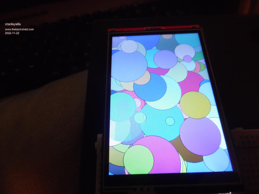

Is there resistor miso again please.I have an ili9488 that dislay works but touch calibrate tests 2 points then fails.Looks same wiring as ili9341 which works.
Posts: 2582
Posted: 12:07am 22 Nov 2022
If you look back through the various ILI9488 threads you will see that the ILI9488 chip has a fault in the silicon that prevents the SDO-(MISO) pin switching off when CS is high. Instead it stays active low, preventing touch and SD cards from using MISO. To get touch working just put a 680R from SDO-(MISO) to your MCU MISO. This may also  allow SD cards to work, but not always. If you have SD issues try this:-

Posts: 2527
Posted: 04:22pm 22 Nov 2022
Thanks phil99 for reply.
My ili9488 has one miso for display which goes to picomite gp16 and display works fine... have not tested read pixel colour though.
so I have sd card miso, touch T_DO. Do I join these as ili9341 OR connect each through diode and 10rK to gp16/miso?
There is a longer thread on this... much longer

Just connect it as per the diagram above. T_DO AND SD_DO go directly to the PicoMite MISO. Only the LCD_SDO has a problem.
You could first try a 680R between SDO and the PicoMite MISO, see if everything works properly (blit, touch & SD). If it does that is all you need to do. Touch should be ok but SD cards might not, in which case use the circuit above.

Posts: 2527
Posted: 05:42pm 24 Nov 2022
  phil99 said  @stanleyella
just lcd and touch connected but gui touch calibrates fails
Posts: 2527
Posted: 06:18pm 24 Nov 2022
@phil99 good day. The ili9488 does graphics ok. like ili9341.
the rest is hassle, I'll put it away cos it is not as easy as ili9341 which just works.
