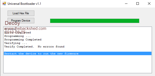

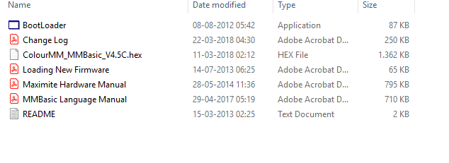

While I ascertain if the diodes need to be 1N4148s...and wait for them to arrive in the mail, I will show what I did to flash the UBW32:
1. I connect the UBW32 with USB to a Win 10 PC
2. I run the BootLoader
3. I flash the UBW32 with ColourMM_MMBasic_v4.5C.hex
4. Bootloader confirms everything is OK
5. I reboot the UBW32, and then nothing is seen by Win 10 (on three diff. PCs)
Thanks,
Nicholas

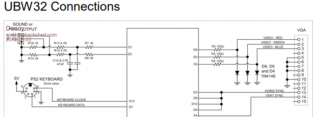

Decoy
Joined: 02/08/2019
Location: Denmark
Posts: 109
Posted: 04:30pm 04 Aug 2019
Hey Michael
From the manual - see picture below. I assumed that some sort of fast switching was needed?
twofingers
Joined: 02/06/2014
Posts: 1761
Posted: 05:56pm 04 Aug 2019
Hi Nicholas (Decoy),
IMHO is the 1N4148 diode a universal standard diode, wich can be replaced (and replace) by almost any "regular" silicon diode.
Please google "1n4148 diode wiki" and "1n4148 diode replacement".
Or just try with some diode of your spare box!
Michael

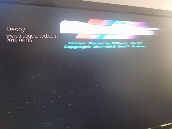

Decoy
Joined: 02/08/2019
Location: Denmark
Posts: 109
Posted: 07:26pm 04 Aug 2019
Okay, the UBW32 is working. I got a picture using 1N4001s and 130 ohm resistors
(didn't have any 120 ohm). The picture is grainy with washed out colors, but that
is probably due to the breadboard and dupont lead upon dupont lead. Or the wrong
resistors?
Thanks for all the help thus far!
twofingers
Joined: 02/06/2014
Posts: 1761
Posted: 07:45pm 04 Aug 2019
Hello Nicholas (Decoy),
congratulations! We are one step ahead. [= D>]
  Quote  (didn't have any 120 ohm)
Ignore that. Later, if available, you can replace the 1N4001 with the 1N4148.
The keyboard works too?
Michael
Turbo46
Joined: 24/12/2017
Posts: 1693
Posted: 09:55pm 04 Aug 2019
Hello Decoy,
The 1N4148 is a high speed switching diode while the 1N4001 is a rectifier diode. This is probably the cause of the bad video. I suggest that you change them when you can. I don't think the resistor value is important.
Good luck and well done so far.
Bill
Posts: 9975
Posted: 11:27pm 04 Aug 2019
Yes, I agree with all the other posts, and well done.
I also agree with Turbo46 above.
4148 diodes are 'Small signal' diodes, and are a fast diode, whereas 4001-4007 are slow-speed rectifier diodes designed for DC power passing/blocking or AC-to-DC rectification, where the frequency is normally less then 100Hz. The three SPI channels used to generate the three VGA colour signals run very fast, and the poor old rectifier diodes probably just cannot keep up with the pulse-rate from those pins.
To put it in simple terms. I too would be very interested to see what happens if you switch the 4001's for the correct 4148's.
Decoy
Joined: 02/08/2019
Location: Denmark
Posts: 109
Posted: 03:13pm 06 Aug 2019
Well, I ordered some 1N4148s locally, for your convinience - this way you didn't
have to wait very long.
I just replaced the 1N4001s with the 1N4148s, and the results were great! See video
below. However, I still suffer from sparkles...also present in the video. Could
this be due to the manual stating that pin 5, 6, 7, 8 on the VGA connector should
be tied to ground? I have not done that, I just snipped the end of a VGA cable.
https://www.youtube.com/watch?v=EZev2BADxrk&feature=youtu.be
Thanks!

Decoy
Joined: 02/08/2019
Location: Denmark
Posts: 109
Posted: 03:21pm 07 Aug 2019
I fixed the problem with sparkles in the RGB video signal.
By connecting the USB cable(for powering the UBW32) to a different charger, the
image became a lot better with no sparkles. When connecting the USB cable to the
USB connector in the monitor, ghosting became almost non-existing. Probably due to
shared ground.
I have hight hopes for the image quality when the real VGA connector shows up,
and I can ditch the breadboard :)
Thanks!
