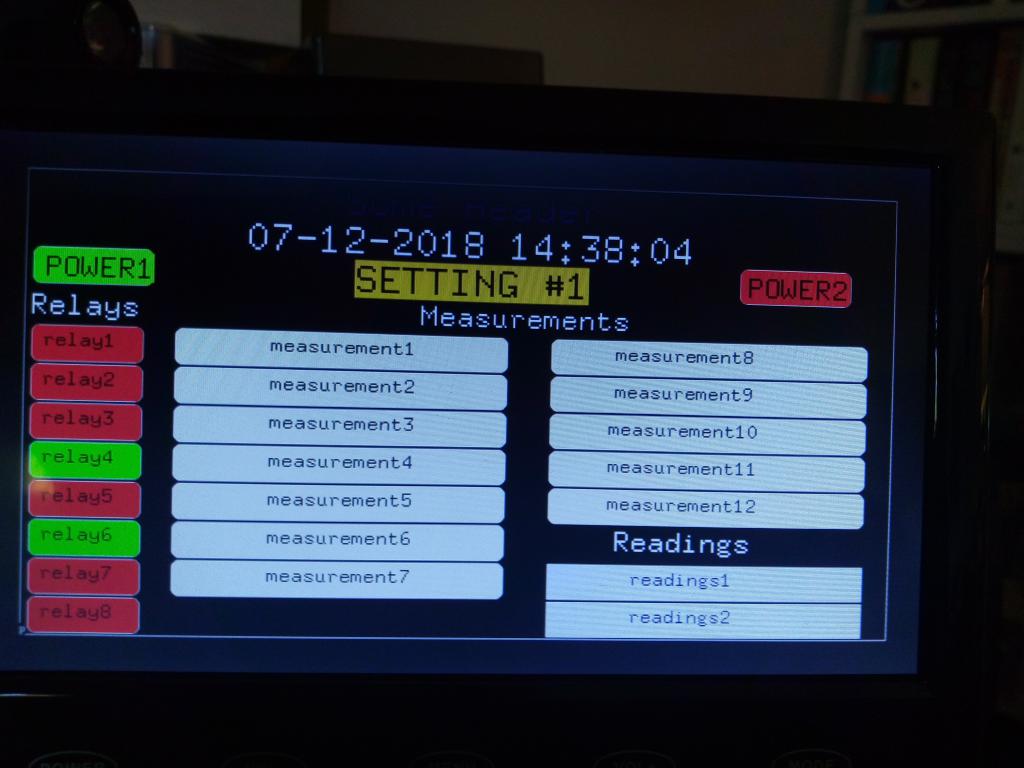

  PeterB said  ... please design a device that plugs into the E64 and outputs HDMI & VGA
Again, if it's mmbasic and hdmi that you want, what's wrong with Pi-Cromite? No new device design required.
Here's pi-cromite hdmi output to a 7" monitor from a pi zero W--1024x600 pixels. (Photo doesn't do justice to the clarity of the display.)
Edited 2019-09-16 22:49 by lizby
