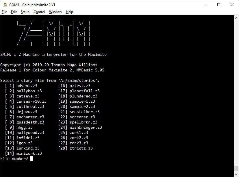

Hey folks, My CMM2 has arrived, thanks to the WhiteWizard and micromite.org. Under the current conditions my free time to play with it will be very limited but for the sake of a smoke test I've updated and executed my (incomplete) Z-Machine implementation: ![]() Best wishes, Tom MMBasic for Linux, Game*Mite, CMM2 Welcome Tape, Creaky old text adventures |

Wow, The CMM2 should allow you to run full ZORK 1. You don't need a mini version. Is there a thread about your ZORK port (I guess you started on CMM).??? I volunteer if you need help, either testing, or coding. Volhout PicomiteVGA PETSCII ROBOTS |
| thwill Guru Joined: 16/09/2019 Location: United KingdomPosts: 4369 |
Thanks it's 50-75% done I think ... But it has been in that state for several months whilst I have been flashing LEDs. Quite right. The original CMM should be capable of running full Zork too as my code implements virtual memory paged from the SD. Speed is the main issue with the CMM implementation. One reason for testing with the mini version is that it is freeware so there is no issue with having it in my GitHub repository. This is now that thread. I have mentioned it in passing a couple of times in the past but nobody expressed interest so I didn't push it. Note it is not Zork that I am porting it is an implementation of the Zmachine. Once complete it will run all the Infocom Z3 format adventure games. Yes and I am still targeting it. However I am hoping the improved speed and editor on the CMM2 will allow me to develop faster. As long as I am careful about which language features I use a back port should then be relatively painless. I'm happy to add you as a contributor to the project on GitHub even if you just want to lurk. It might even encourage me to work more proactively on it. Best wishes, Tom Edited 2020-05-15 17:59 by thwill MMBasic for Linux, Game*Mite, CMM2 Welcome Tape, Creaky old text adventures |
