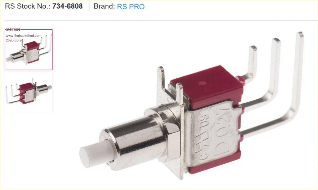

| matherp Guru Joined: 11/12/2012 Location: United KingdomPosts: 11513 |
The switch listed is down=on but there is a push-on push-off switch with the same footprint and physical layout for those perverse enough to believe this is incorrect |

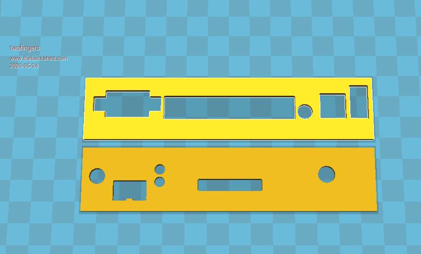

| panky Guru Joined: 02/10/2012 Location: AustraliaPosts: 1127 |
Even a relatively entry level 3D printer (mine is a FlashForge Finder - you can get one for just over A$400 if you shop around) can print to +/- 0.5mm which is more than sufficient for the front and rear panels. The .STL files you need to feed to your slicing software that comes with the 3D printer can be seen on this page If you need to, you can edit the .STL files with FreeCAD or any other CAD program. Also, while the finish on the #D result is pretty smooth, if you want REALLY flash, you can buy some Ultra High Gloss label paper for your inkjet printer and affix this to the panels. ... almost all of the Maximites, the MicromMites, the MM Extremes, the ArmMites, the PicoMite and loving it! |
