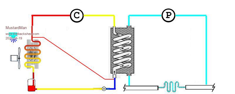

This image from one of the above posts is the candidate used.
The attached zip file contains the above pump256.BMP It is the schematic from  above
saved as 256 colours to increase the possibility of runs of pixels the same colour.
This 800*320  image is around 311 pages when saved to flash. It restores to the LCD in about 110ms. This refresh looks instantaneous when changing screens.
