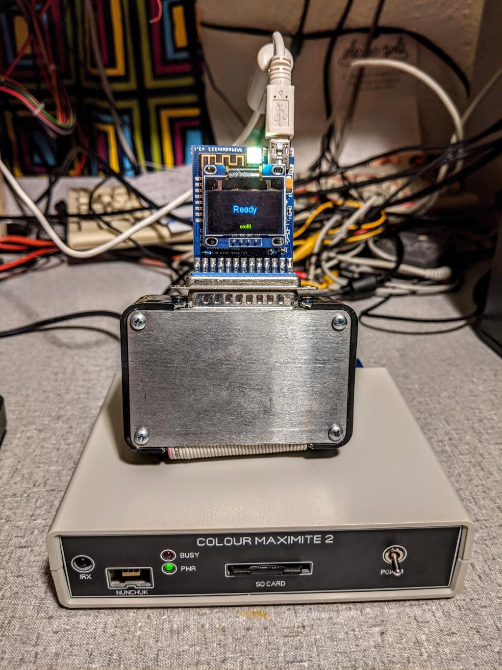

I can vouch for this because when I first tried interfacing a TTL serial port to the CMM2 I couldn't get any data to flow to the CMM2. After many hours of pulling my hair out I finally realized that the RTS pin on the TTL device had to be grounded before it would send its data.  It was sitting there buffering everything until that pin was asserted.
Ran into a similar issue interfacing the WiModem232 (which luckily uses 5V levels) until I was able to disable flow control on the device. But a 5 pin internal header with GND,Rx,Tx,RTS,CTS would be a sweet new addition in the future.

I think you all are still missing the point that this hardware functionality which is already present in the ARM could have been used to make this a non-issue, and still can be in the future if UART7 or similar has all of its pins exposed. An earlier commenter seemed to make our point by saying that although terminal programs and BBSing might not demand these features, having these real flow control features would likely be needed for devices that have higher throughput and more hard timing requirements. It seems that having RTS/CTS pins accessible and supported in the firmware would have removed a lot of the BASIC overhead associated with managing it. But we've argued enough about the topic, so moving on. We'll play in the sandbox as it is. </BEAT DEAD HORSE>
I'm going to use GPIO pins 32 & 33 for the RTS/CTS purpose as they are 5V tolerant and have no other dedicated function. One question though, how am we supposed to monitor the buffer state on the COM1/COM2 RX to know if the DCE needs to pause while the CMM2 catches up? In other words, is there a register or some BASIC command which can poll or monitor the buffer state to watch for potential overflows?
It's easy enough for the CMM2 to stop sending when the DCE gets overwhelmed, but not sure how to monitor for the opposite in this circumstance.

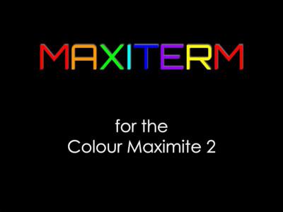

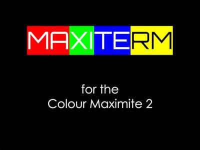

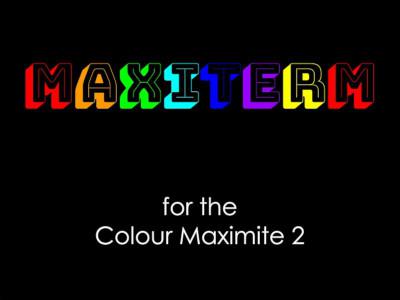

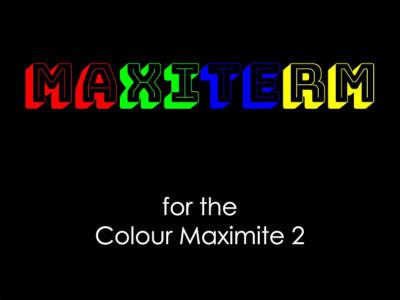

In more frivolous news, tell me which title card into you all like better for the startup screen of the terminal program:
Version 1:
Version 2:
Version 3:
Version 4:
Edited 2020-10-11 02:55 by frnno967
