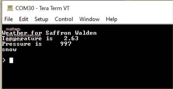

Attached is some code that uses the openweathermap.org api which is called using an ESP-01 with the default "AT" firmware. You need to substitute your own wifi login details and your own openweathermap api username and key in lines 3, 4, and 14 to get it to work. This is code I previously published to work on the Micromite eXtreme  that works without a single change on the CMM2 - Isn't compatibility wonderful
You can see from the local report why I have so much time for coding

print #1,b$;
getinput(10000)
Print "Weather for "+json$(m%(),"name")
Print "Temperature is ",val(json$(m%(),"main.temp"))-273
Print "Pressure is ",json$(m%(),"main.pressure")
Print json$(m%(),"weather[0].description")

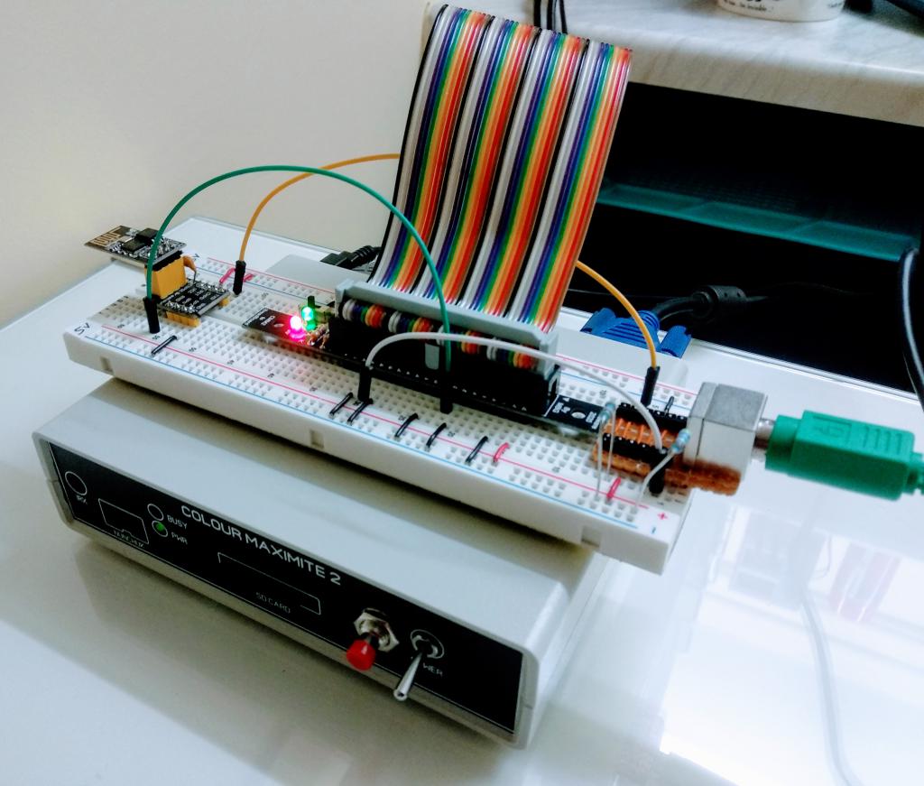

How is it possible for the regular CMM2 to access Wifi/Internet?
Is there a guide somewhere, or does it require the special 'deluxe' model?
Posts: 10181
Posted: 05:11pm 30 Jan 2021

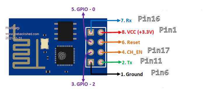

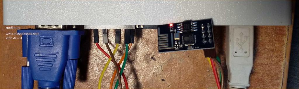

This is for running on a regular CMM2 - just connect a standard ESP-01 to com port 2 and power it from 3.3V/GND (make sure the CH-PD pin is also pulled high) and you have network access
Edited 2021-01-31 03:39 by matherp
Posts: 4299
Posted: 05:35pm 30 Jan 2021
  matherp said  This is for running on a regular CMM2 - just connect a standard ESP-01 to com port 2 and power it from 3.3V/GND (make sure the CH-PD pin is also pulled high) and you have network access
@matherp
Didn't you say we shouldn't drive an ESP-01 from the CMM2's power rails a couple of months back because it can draw too much current under some loads?
Posts: 10181
Posted: 05:40pm 30 Jan 2021
Seems to test OK but put a 2.2R resistor in the 3.3V line and a 100uF cap across the ESP-01 if any problems
Edited 2021-01-31 03:43 by matherp
Posts: 4299
Posted: 05:46pm 30 Jan 2021
Did you really mean a 2.2 ohm resistor ... do they come that small, other than 0 ohm SMDs ?
Posts: 10181
Posted: 05:51pm 30 Jan 2021
Yes 2R2 as used already on the CMM2 in the power supply to the SDcard. Together with the cap just slows the spikes slightly
Edited 2021-01-31 03:54 by matherp

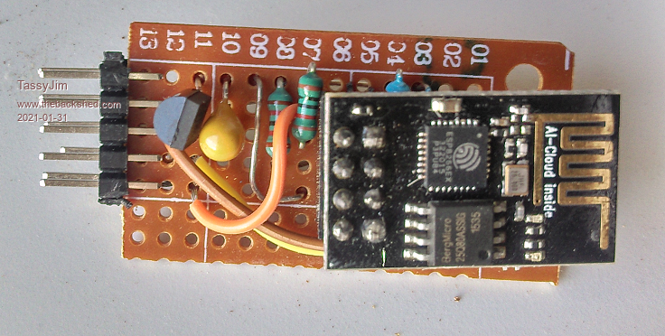

Posts: 6266
Posted: 08:30pm 30 Jan 2021
I used the 5V supply with a 3.3V regulator for my ESP interface.
I also used com1 so that all the pins are together on the expansion port.
Thank you for json, I wasn't looking forward to doing that in Basic.
Posts: 3348
Posted: 10:32pm 30 Jan 2021
Jim--what high-current 3V3 TO-92 regulator did you use?
PicoMite, Armmite F4, SensorKits, MMBasic Hardware, Games, etc. on fruitoftheshed
Posts: 6266
Posted: 11:08pm 30 Jan 2021
  lizby said  Jim--what high-current 3V3 TO-92 regulator did you use?
MCP1700
Posts: 3348
Posted: 11:15pm 30 Jan 2021
Ok, I've got some of those--in Box #10, my notes say, if I can find that.

Posts: 4299
Posted: 01:40pm 31 Jan 2021
Thanks for providing a morning's amusement Peter.
I found I had to replace:
dim b$= "GET /data/2.5/"+report$+"?id="+MYID$+"&APPID="+APIKEY$
with:
dim b$= "GET /data/2.5/"+report$+"?q="+MYID$+"&APPID="+APIKEY$
Otherwise it complained that "manchester,uk" was not a valid city, which I thought was rather opinionated for a computer
I've also found my ESP-01 module to not be terribly stable, sometimes it works, but othertimes it only flashes its LED on initial power-up and then will refuse to flash it further or make a connection. It will then stubbornly refuse for a while whilst I faff with the cables and switch things on and off a couple of times, or attach it to an external power supply and then it will decide it will work again after all even when connected back to the CMM2 3.3V power rail ??? Maybe that resistor and capacitor will help when the former arrives. TBH I'm not convinced that the 3.3V rail is always supplying 3.3V ... sometimes I'm measuring as low as 2.8V - though I must acknowledge there may be a certain amount of incompetence involved.
Anyway, if we get many more upgrades then I think I'm going to need a bigger breadboard:

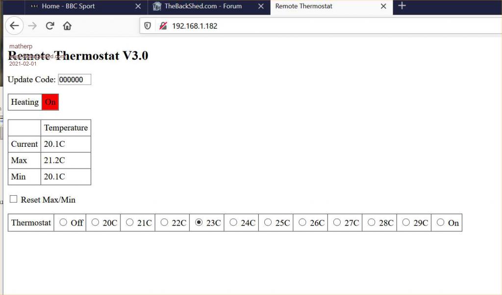

Here is a simple webserver using the ESP-01 in tcp server mode. Just substitute the login for your network in lines 8 and 9
Option explicit

 Print "Connected"
main:
DO
 currenttemp=cint(tempr(dspin)*10)
 updateheater
 tempr start dspin,3
 maxmin 'update the maximum and minimum and save them if changed
 if ReadRequest(waittime) then 'process HTML request
   mypage$=ucase$(parsehtmldata$(nparams)) 'parse the html request and get the page requested
   if mypage$<>"" then 'real request so do something
     if mypage$= "INDEX" then
       drawpage
     elseif mypage$="D" then
       if nparams<>0 then 'we have parameters to process
         if arg$(0,0)="S" and arg$(1,0) = password$ then
           if arg$(0,1)="C" and arg$(1,1)="R" then 'reset the max min to current
             maxtemp=currenttemp
             mintemp=currenttemp
             var save setpoint,maxtemp,mintemp
           endif
           if arg$(0,1)="R" then 'change the setpoint and update the heater if applicable
             setpoint=asc(arg$(1,1))
             updateheater
           endif
         endif
       endif
       drawpage
     else
       SendText pnf$+crlf$+crlf$'invalid page
     endif
     EndSend 'clear the write buffer and terminate the write
   endif
 endif
LOOP
end
Function parsehtmldata$(paramcount as integer)
 local a$,b$
 local integer buf(Maxlen\8)
 local integer inpos,startparam,processargs
 paramcount=0
 inpos=lInstr(inbuf(),"GET /",1)
 if inpos=0 then
   parsehtmldata$=""
 else
   longstring mid buf(),inbuf(),inpos+5,1000
   inpos=lInstr(buf(),starttext$,1)
   If inpos>2 Then 'page request found
     inpos=inpos-2
     a$=lGetStr$(buf(),1,inPos)
     inpos=Instr(a$,"?")
     If inpos<>0 Then 'parameters found
       processargs=1
       parsehtmldata$=Left$(a$,inpos-1)
       a$=Mid$(a$,inpos+1)
         arg$(0,paramcount)=""
         arg$(1,paramcount)=""
         inpos=Instr(a$,"=")
         startparam=1
         arg$(0,paramcount)=Mid$(a$,startparam,inpos-startparam)
         startparam=inpos+1
         inpos=Instr(a$,"&")
         If inpos<>0 Then
           arg$(1,paramcount)=Mid$(a$,startparam,inpos-startparam)
           a$=Mid$(a$,inpos+1)
           paramcount=paramcount+1
         Else
           arg$(1,paramcount)=Mid$(a$,startparam)
           processargs=0
         EndIf
       Loop while processargs
     Else
       parsehtmldata$=a$
     EndIf
   Else ' no page requested
     parsehtmldata$="INDEX"
   EndIf
 endif
End Function
sub maxmin
 local integer update=off
 if currenttemp>maxtemp then
   maxtemp=currenttemp
   update=on
 endif
 if currenttemp<mintemp then
   mintemp=currenttemp
   update=on
 endif
 if update then var save setpoint,maxtemp,mintemp
end sub
sub updateheater
 local integer hcalc
 if setpoint=asc("L") then
   pin(relaypin)=ON
   heater=on
 endif
 if setpoint=asc("A") then
   pin(relaypin)=OFF
   heater=oFF
 endif
 if setpoint>=asc("B") and setpoint<=asc("K") then
   hcalc=(setpoint-asc("B")+starttemp)*10 'setpoint temperature * 10
   hcalc = hcalc + hysteresis
   if currenttemp>=hcalc then 'turn heating off
     pin(relaypin)=OFF
     heater=oFF
   endif
   hcalc = hcalc - hysteresis - hysteresis
   if currenttemp<=hcalc then 'turn heating on
     pin(relaypin)=ON
     heater=oN
   endif
 endif
end sub
sub drawpage
 local integer loopcounter,tempconvert
 local b$
 sendText header$
 sendText title$+form$+h2$+code$
 sendText tstart$+heat$
 if heater then
   sendText hon$+tend$
 else
   sendText hoff$+tend$
 endif
 sendText tstart$
 sendText h3$
 b$=s1$+outtemp$(currenttemp)+degree$
 b$=b$+s2$+outtemp$(maxtemp)+degree$
 b$=b$+s3$+outtemp$(mintemp)+degree$
 sendText b$
 sendText tend$
 sendText check$
 sendText tstart$
 sendText s4$
 for loopcounter=asc("A") to asc("L")
   if loopcounter=setpoint then
     sendText s5$+chr$(loopcounter)
   else
     sendText s6$+chr$(loopcounter)
   endif
   sendText click$
   tempconvert=loopcounter-asc("B")+starttemp
   if loopcounter>asc("A") and loopcounter<asc("L") then sendText str$(tempconvert,2)+degree$
   if loopcounter=asc("A") then sendText offstr$
   if loopcounter=asc("L") then sendText onstr$
 next loopcounter
 sendText tend$
 sendText ending$+crlf$+crlf$
end sub
