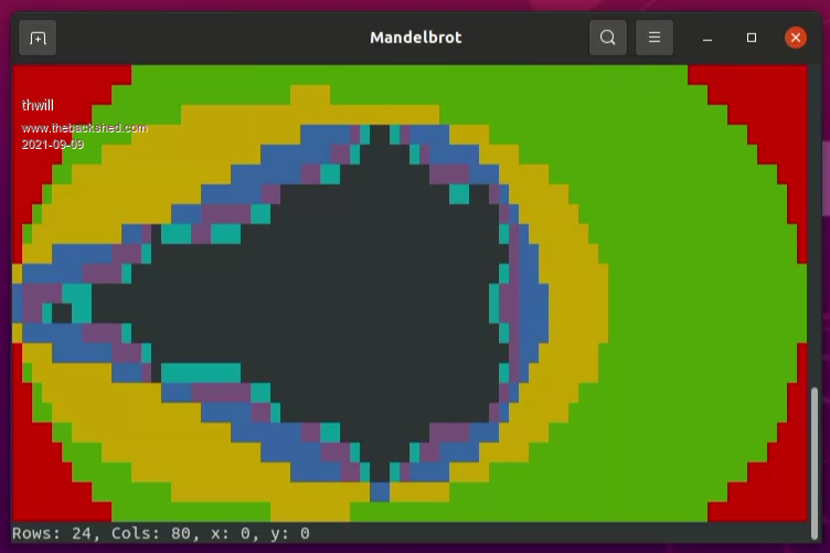

It is not my intention to bloat MMB4L with lots of extensions to MMBasic but I got distracted from my main TODO list and had a bit of a play yesterday evening.
Video shows integration with the 'nano' editor and the new CONSOLE command that I've added specifically for the Linux version.
   https://youtu.be/oZCO5qpnAAA
Screenshot:
Program (MMB4L only):
' Demonstration of CONSOLE commands for MMB4L
Option Base 0
Option Default Float
Option Explicit On
Dim cols%, rows%
Console SetTitle "Mandelbrot"
Dim count%, k%, redraw%, x%, y%
update_display()
 k% = Asc(Inkey$)
 Select Case k%
   Case &h80: Inc y%, -1 : redraw% = 1
   Case &h81: Inc y%,  1 : redraw% = 1
   Case &h82: Inc x%, -1 : redraw% = 1
   Case &h83: Inc x%,  1 : redraw% = 1
 End Select
 Inc count%
 If count% = 1000 Then redraw% = 1
 If redraw% Then
   update_display()
   redraw% = 0
   count% = 0
 EndIf
Sub update_display()
 If size_changed%() Then draw_mandelbrot()
 If x% < 0 Then x% = 0
 If x% >= cols% Then x% = cols% - 1
 If y% < 0 Then y% = 0
 If y% >= rows% Then y% = rows% - 1
 Local s$ = "Rows: " + Str$(rows%) + ", Cols: " + Str$(cols%)
 Cat s$, ", x: " + Str$(x%) + ", y: " + Str$(y%)
 s$ = Left$(s$, cols%)
 s$ = s$ + Space$(Max(0, cols% - Len(s$)))
 Console HideCursor
 Console SetCursor 0, rows% - 1
 Console Foreground White
 Console Background Black
 Print s$;
 Console SetCursor x%, y%
 Console ShowCursor
End Sub
Sub draw_mandelbrot()
 Local c%, it%, max_it%, x, x0, y, y0, xtemp
 Console Reset
 Console HideCursor
 Console Clear
 For x0 = -2 To 2 Step .01
   For y0 = -1.5 To 1.5 Step .01
     x = 0
     y = 0
     it% = 0
     max_it% = 7
     Do While (x * x + y * y <= (2 * 2) AND it% < max_it%)
       xtemp = x * x - y * y + x0
       y = 2 * x * y + y0
       x = xtemp
       Inc it%
     c% = Choice(it% = max_it%, 0, it%)
     Console Background c%
     Console SetCursor (cols% / 4) * (x0 + 2), (rows% / 3) * (y0 + 1.5)
     Print " ";
   Next
     x0 = -2
     Console Reset
     Console Clear
   EndIf
 Next
End Sub
Function size_changed%()
 Local new_cols%, new_rows%
 Console GetSize new_rows%, new_cols%
 size_changed% = (new_cols% <> cols%) Or (new_rows% <> rows%)
 cols% = new_cols%
 rows% = new_rows%
End Function

Very nice! :)
Posts: 3348
Posted: 03:15pm 09 Sep 2021
Sweet. I'm liking "console".
