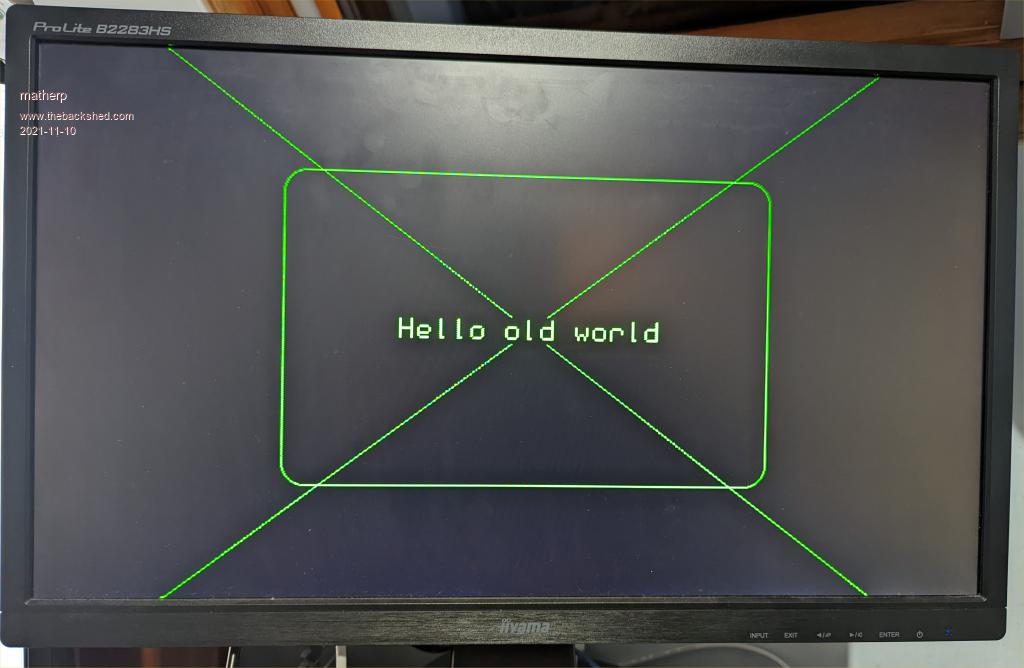

The "Blackpill" has been around for some time and is a very cheap DIL module with an STM32 processor. There are a number of processors available but the interesting one is the STM32F411CEU6
Basically the same size as the Pico, a little bit dearer but a much more conventional chip (onboard flash, lots of timers, a great IDE, and I know the F4 inside-out)
I've been playing with a mock-up of things I could do with this chip
The attached image shows it running a 640x480 VGA display using one resistor and one diode
It would be possible with a relatively small amount of work, taking code from the ArmmiteF4 to create a first gen style computer but with a modern language running at a 100MHz clock speed. The Blackpill includes space on the underside for a flash chip which if fitted could be used as a file storage device with no need for a SDcard. This approach is already used on  the ArmmiteL4.
I would implement a PS2 keyboard (like the Maximite) so that you could program completely stand-alone or you could use a serial console as per the Micromite.
Due to memory limitations in order to get a nice display it would be monochrome. There would be around 64K of variable memory and the same again for a program stored in the processor
The 48-pin 411 supports 10 12-bit ADC and would probably have something like 2 or 3 uarts 2 SPI, 1 I2C 5 PWM and the usual count/frequency input/IR etc.
The video generation as displayed is created using an SPI output under DMA so has very little impact on performance.
This is my take on the sort of thing people have been discussing with the TTG-VGA but with some proper I/O available
Thoughts ?

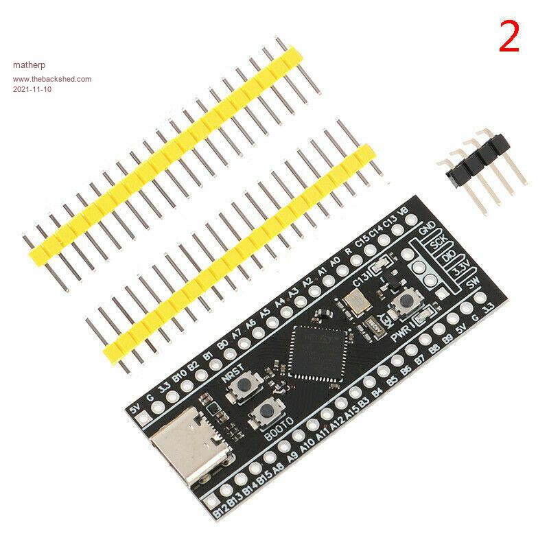

Is it this one ?
Sounds like it would be great - they're very cheap and plentiful I think.

I'm guessing it's this one...

I'll make up for it. More info on board here. It looks like a nice little board. The PS/2 keyboard lovers would be happy, the VGA lovers would be 1/3 happy and the SDcard lovers might not be too happy. It would be handy having more analogue inputs than the PicoMite sometimes. A single I2C looks limiting at first, but you don't need one for a RTC in this case. Looks good. :)
