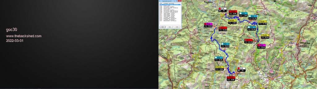

  matherp said  How about I get rid of full screen mode completely but create a new mode for 1080p screens which is the maximum size that will fit above the task bar completely within the screen. Something like 1850x980? I can play with the setting to get the optimum
MS Window, from win3.11 to win11 can draw window with or without any border in full screen  from EGA to XGA or Full HD, I don't understand why it is not possible in MMBasic.
I have somes progs who use full screen without border, like Maps, for 1 to 4 screen. It work perfect with vb6, but now with win10 and win11, it is more difficulte to execute. For that I can be interesting by MMB, but if it is not possible to work in full screen without border, I must search other langage Lazarus or Purebasic
exemple

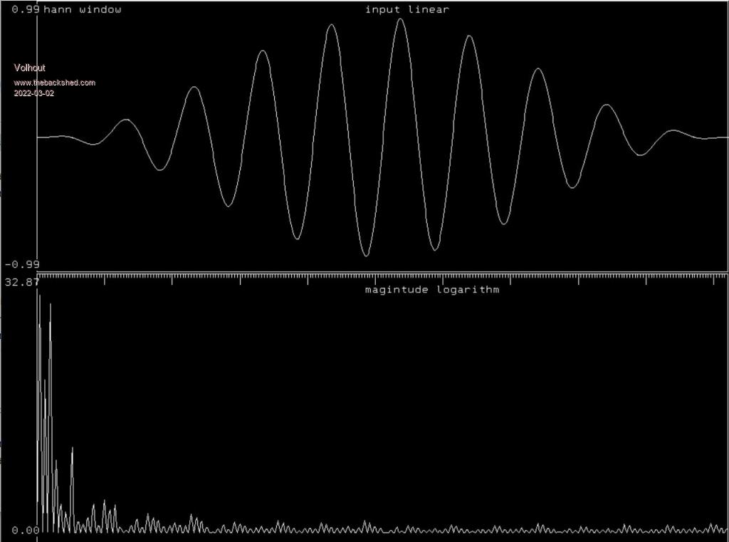

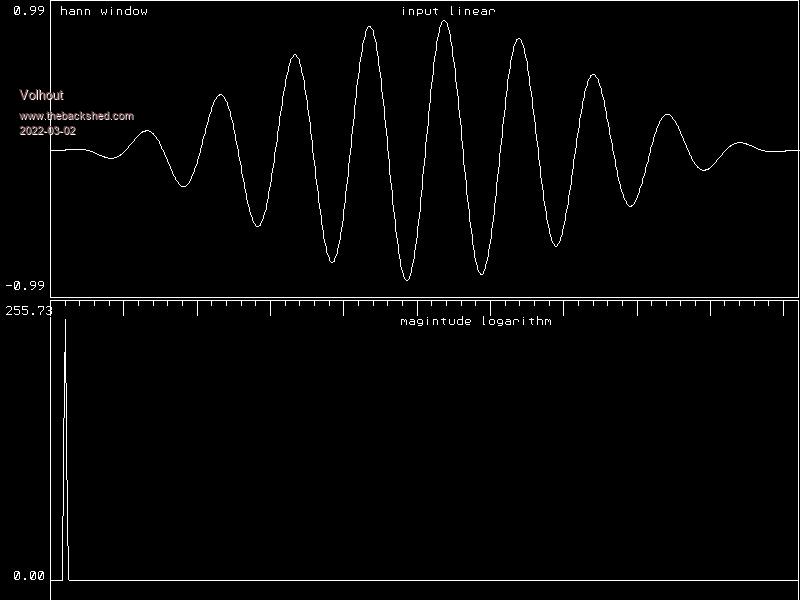

Hi Peter,
Please check the MATH FFT function. For CMM2 we had to fix it, and for MMB4W we seem to run into a similar issue (although not identical).
When I take the FFT magnitude from a sinesquare windowed sine wave, and display it in linear scale, it should look like this (CMM2 fft calculation from below program):
However, the MMB4W math function shows many spurious peaks. Below graph shows the sinesquare windowed sine signal (top), as well as the fft (lower graph)
I use this code to check it (the program can change the windowing function with "w", and change the number of sinewaves for fft with "a" and "z", and save the graph to disk with "s").

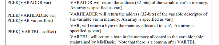

Posts: 4302
Posted: 09:37am 03 Mar 2022
  KD5ZXG said  We may already have a way for finding variables I am unaware of.
CMM2 Manual:
And there are corresponding POKEs for VAR and VARTBL.
PEEK(VARHEADER) is currently unimplemented in MMB4W but I suspect that is just an oversight that Peter will address.
This doesn't help with the DATA pointer since that is not an MMBasic variable - and infact is two internal variables which need to be updated as a single atomic unit.
  KD5ZXG said  What feature is missing that wants direct access to this pointer?
There is a fundamental design flaw in the whole BASIC DATA concept, you can't iterate through multiple DATA sections "simultaneously" because there is only one (hidden) pointer. Workarounds include either reading an entire DATA section into memory before operating on it, or designing the format of your DATA such that you can always RESTORE it to the start and then iterate through it to find a point you were at previously.

Fourier transform works on repetitive signals. (google "wiki FFT").
In theory these signals repeat until eternity.
If you take a snapshot of these signals (i.e. 10 sine waves) the beginning and the end of the 10 sine waves represent a distortion of the "eternal signal", they are distortions.
To minimize the disruption effect of the beginning and end of the snapshot, each sample in the snapshot is "weighted". It's contribution to the Fourier Transform is made more -or less- important. The "weighting" is called "windowing".
There are many types of windows. There is a rectangular window (meaning all samples have the same weight), there is triangular weighting (the first and last samples have zero weight, the centre samples have maximum weight. Samples in between have a weight that is a linear interpolation between first and centre sample.
If you execute the program in my post, and press "w" a few times, you see a number of windowing techniques, and the effect on waveform and FFT.
One of the weighting standards is the "Hann Window". This is similar to the triangular windowing, but samples between first and centre are weighted with a sine^2 function.
Play with the program, and experience.
Vohout
note: the FFT window shows linear magnitude FFT for demonstration purpose (the lin2log function is commented out).
