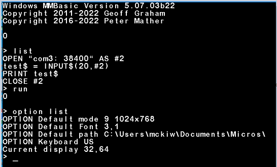

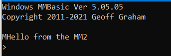

Turbo46![]() Guru ![]() Joined: 24/12/2017 Location: AustraliaPosts: 1639 |
Sorry Peter, This what I see. I am running it from MMEdit but I don't see how that could affect anything. ![]() Same program with MMBasic DOS ![]() This program still crashes MMB4W. OPEN "com3: 38400" AS #2 input #2, test$ print test$ CLOSE #2 Bill Keep safe. Live long and prosper. |
matherp Guru ![]() Joined: 11/12/2012 Location: United KingdomPosts: 10233 |
What is the zero when you start up? Have you got something running - try deleting .options |
The zero comes from running the program at startup, MMEdit runs the program when it starts MMB4W. It's the same zero that you see after I type RUN. I have no strange OPTIONS set I believe. One thing though, the program being run is not in my default directory it is in a subdirectory of /micros > /micros/MMB4W but I can't see how that can have any bearing. But... ![]() Sorry off to bed now. Bill Keep safe. Live long and prosper. |

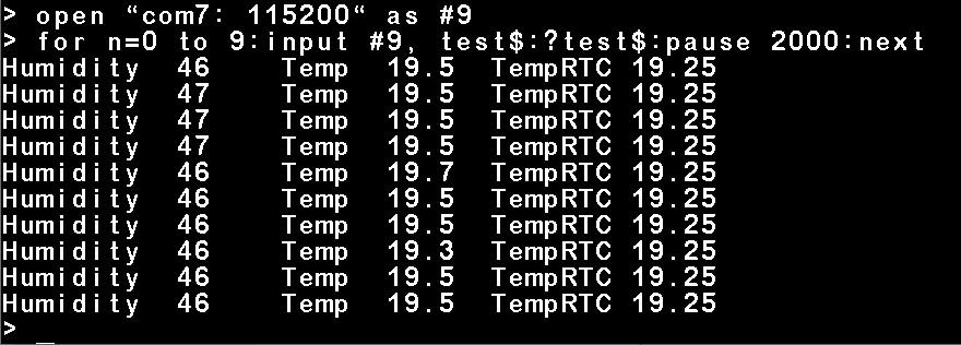

phil99![]() Guru ![]() Joined: 11/02/2018 Location: AustraliaPosts: 2608 |
Not seeing a problem. Sending "hello" at 10mS intervals from a PicoVGA MMB4W receives ok. Pico do :? "hello" :pause 10 :loop MMB4W > ? mm.ver 5.07032 > open "com7: 115200" as #9 > for n=0 to 9 :input #9, test$ :? test$ :pause 9 :next hello hello ... > Edit Down loaded the latest 5.070322 .exe and same result. Output from another program. ![]() Edited 2023-12-21 22:29 by phil99 |

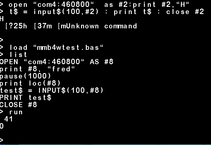

TassyJim![]() Guru ![]() Joined: 07/08/2011 Location: AustraliaPosts: 6269 |
Sorry, but I still can't get it to work. Works OK from the command line as per Phil but not in a program. ![]() Running in a program does send to the cmm2 and the receive buffer gets the data returned but unable to retrieve from the rx buffer. OPEN "com4:460800" AS #8 PRINT #8, "fred" PAUSE(1000) PRINT LOC(#8) test$ = INPUT$(100,#8) PRINT test$ CLOSE #8 Jim Edit: If you use INPUT #8, test$ it works OK so the problem is with the INPUT$(nn,#x) command. Edited 2023-12-22 06:40 by TassyJim VK7JH MMedit |
I think I have gone as far as I can with this. OPEN "com4:460800" AS #8 PRINT #8, "fred" PAUSE 1000 atest$ = INPUT$(100,#8) PRINT atest$ CLOSE #8 works OPEN "com4:460800" AS #8 PRINT #8, "fred" PAUSE 1000 test$ = INPUT$(100,#8) PRINT test$ CLOSE #8 fails The only difference is the second code uses test$ as the variable name. Baa Humbug... Jim VK7JH MMedit |

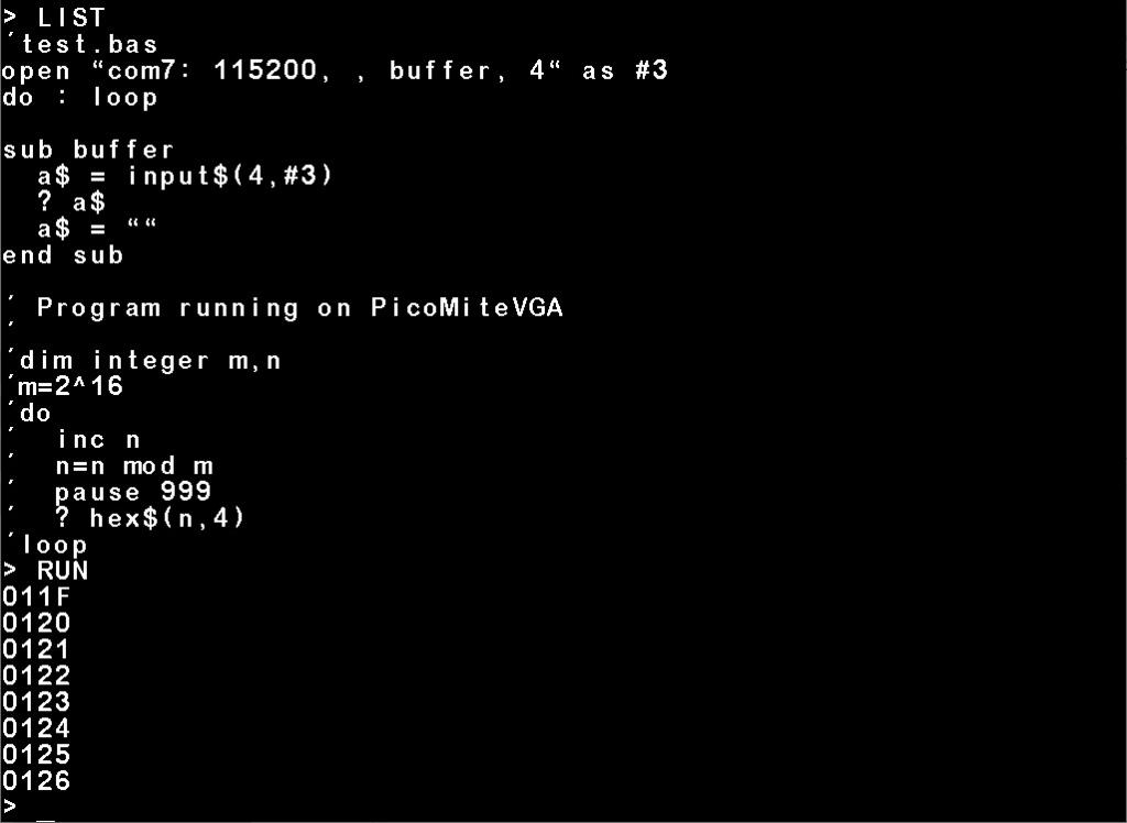

This works quite well. Sending Bin$ to make it easier to see what is happening. Change to Hex$ for practical use, adjusting receive end to match. 'test.bas open "com7: 115200, , buffer, 16" as #3 do if flag then flag = 0 ? a$ endif loop sub buffer a$ = input$(16,#3) flag = 1 end sub close #3 end ' Program running on PicoMiteVGA ' dim integer m, n m = 2^16 do inc n n = n mod m pause 999 ? bin$(n,16) loop end Edit. ![]() Edited 2023-12-22 13:00 by phil99 |

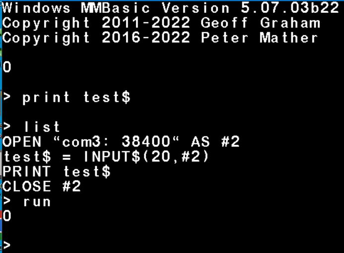

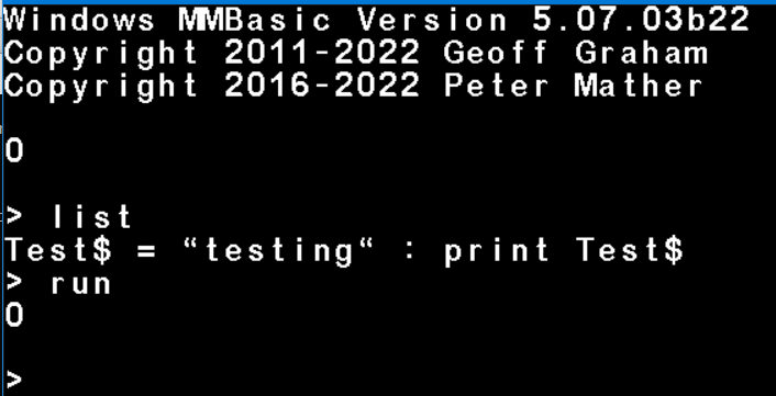

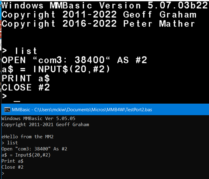

Hmmm. The plot thickens. Maybe the variable name TEST is part of some internal debugging code: ![]() The first zero is because the program is run immediately it is loaded. It does work on MMBasic DOS. Bill Keep safe. Live long and prosper. |
So I changed the name from test$ to a$ and ran it again. ![]() As you can see it doesn't print zero now but prints nothing. Again it does work on MMBasic DOS. I wonder if MMBasic DOS empties the com buffer as it opens the port while MMB4W doesn't? From that and TassyJim's test it does seem the TEST is some kind of internal variable that overrides it's use in a program. Bill Keep safe. Live long and prosper. |
"test" is used as a variable name in the source code in commands.ccp and one of the json files. Perhaps it has escaped it's local status and become global. VK7JH MMedit |

I wondered about that. If I stop and restart my MMB4W program (a few posts above) sometimes the lower characters remain static while the higher characters count up at the rate that the lower characters should, suggesting there are already a few in the receive buffer. It's also possible the program started mid-transmission, it has no means of getting back in step. Discarding the first input$ might be a solution. Adding CLEAR to the start of the program seems to fix it, though might be just luck. Edit So far this seems ok, 'test 2.bas clear open "com7: 115200" as #3 pause 10 a$ = input$(255,#3) a$ = "" close #3 pause 10 open "com7:115200,, buffer, 4" as #3 pause 10 do If flag then ? a$ flag = 0 endif loop sub buffer a$ = input$(4,#3) inc flag end sub Edited 2023-12-22 15:01 by phil99 |
