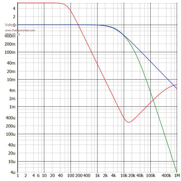

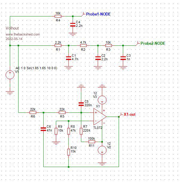

For a 10kHz PWM you could try the opamp circuit at below:
It converts 3.3V PWM to +/- 10Vdc
The opamp (TL072) is not critical. It combines gain with active filtering.
The active filter for rejecting the 10kHz to below 1mVrms.
I added the other (100kHz filters) in the graph below. These are not suitible.
The conversion from 3.3V to +/-10V can be seen here.
I used E12 resistors (so 62k is 47k+15k, 320k=220k+100k) to use easily available components.

@Volhout: Many, many thanks for this...this is HUGELY appreciated!
Whilst my crude DAC does work, it just doesn't feel refined enough.
I will run both versions to compare
Not sure if I have the required component values but I will order them if not.

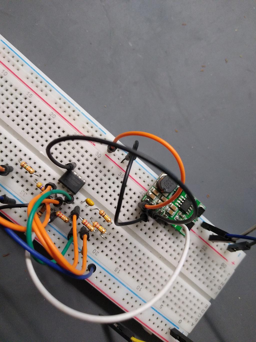

Got sidetracked yesterday so only got to play with this stuff today.
Volhout's circuit appears to be working well on the breadboard:
14 bits give me a resolution of 0.0012V and I'm getting those increments
Slight (expected) null-offset, the zero-point is 8059 as opposed to 8192
Craig

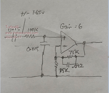

Sounds like you have already discarded the suggestion but I'll show it anyway.
This circuit has a low pass 3 db point at 100Hz with a gain of 6. It is non inverting unlike the original and will give a symmetrical output. This gives a higher input impedance which allows for higher value resistors and therefore smaller capacitors.
The AC input coupling will mean that the output will drop to zero if the input fails.
The gain could be nudged up by adding a high value resistor in parallel with the 15k or down with a small value resistor in series with the 75k. No filing.
FWIW
Bill
Edited 2022-05-17 16:05 by Turbo46

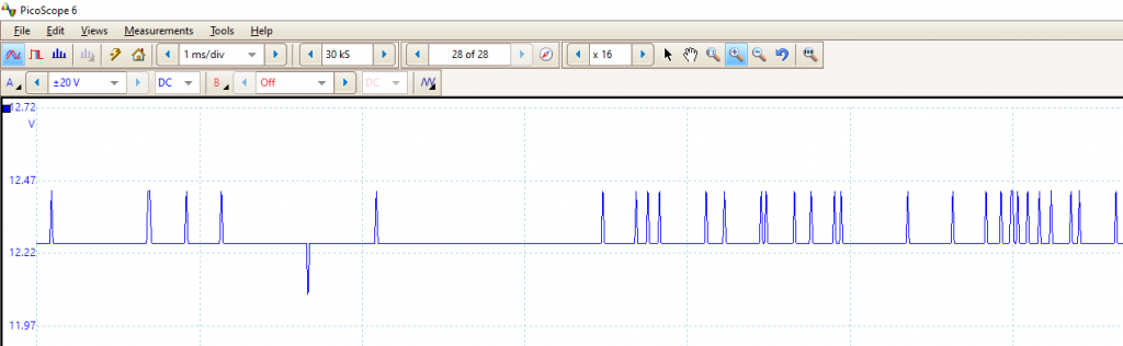

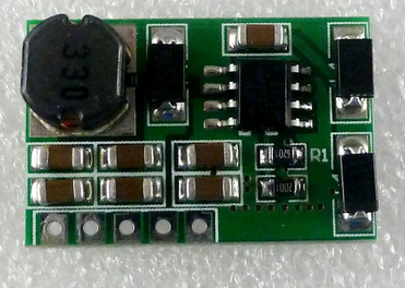

Getting these spikes directly from the buck-booster (5v to +/-12v).
Is this "tolerable" or do I need more filtering?
I don't intend to actually use this booster beacuse I use an ATX Pico power supply but I suspect that I might see something similar.
Craig

  Turbo46 said  Sounds like you have already discarded the suggestion but I'll show it anyway.
FWIW
Bill
Hey Bill
I'm always interested. Would you please re-post the sketch without the watermark?
Cheers!
Craig
Turbo46
Joined: 24/12/2017
Posts: 1639
Posted: 06:40am 17 May 2022
Done.
