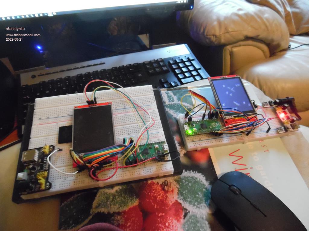

Dim var as byte gets accepted in mmedit. Does it work or are the minimal var values words?
What is the best way of adding minus values or even declaring them. I don't want floating point so dim all vars.
dx=-2:dy=-4
spx=spx+dx:spy=spy+dy

Hi there,
MMBasic doesn't have a BYTE type, so don't know what is going on there. The supported types are INTEGER, FLOAT and STRING.
On recent 'mite platforms INTEGER and FLOAT are both 64-bit not sure about historical platforms, I think the CMM1 had 32-bit FLOATs and no INTEGERs.
INC spx, dx
INC spy, -dy
is faster than:
spx = spx + dx
spy = spy - dy
Regarding declaration I suggest beginning every program with the "holy trinity":
OPTION BASE 0        ' 0 based arrays
OPTION DEFAULT NONE  ' Don't assume a type for variables
OPTION EXPLICIT      ' Force variables to be declared in advance with
                     ' DIM, LOCAL, CONST or STATIC

Thanks. MMbasic is new. I'm converting a great cow basic program to mmbasic on rpi pico. Lots of differences. Would read data+256 work?
I'm using arrays cos I haven't figured data and read but is this how to set up an array with values.. colours..word values.
For minus numbers do I use integers or is -1=65535?
I have not run/tested as I'm using mmedit v4.xxx and not a clue how to make it run with pico connected. Using teraterm but not happy using a terminal, It's all strange.

Posts: 11882
Posted: 06:30pm 02 Aug 2022
You can't split MMbasic commands across lines
cannon=(bk,bk,bk,bk,bk,wh,wh,bk,bk,bk,bk,bk
bk,bk,bk,bk,ye,cy,cy,ye,bk,bk,bk,bk
bk,bk,bk,ye,cy,wh,wh,cy,ye,bk,bk,bk
bk,bk,bk,ye,cy,cy,cy,cy,ye,bk,bk,bk
bk,bk,ye,ye,cy,wh,wh,cy,ye,ye,bk,bk
bk,bk,ye,cy,cy,cy,cy,cy,cy,ye,bk,bk
bk,ye,bl,bl,bl,re,re,bl,bl,bl,ye,bk
ye,ye,bl,bl,bl,re,re,bl,bl,bl,ye,ye
bk,bk,ye,re,re,re,re,re,re,ye,bk,bk
bk,bk,bk,ye,fu,fu,fu,fu,ye,bk,bk,bk)
You need to use DATA and READ, they really are very easy.

Posts: 9136
Posted: 07:31pm 02 Aug 2022
If you are using DATA and READ then you need to read the data using a loop. You can't simply fill an array in one statement.
e.g.
DIM cannon(120)
RESTORE cannon
for i=1 to 120
READ cannon(i)
next
cannon:  'this is a label
DATA bk,bk,bk,bk,bk,wh,wh,bk,bk,bk,bk,bk
DATA bk,bk,bk,bk,ye,cy,cy,ye,bk,bk,bk,bk
DATA bk,bk,bk,ye,cy,wh,wh,cy,ye,bk,bk,bk
DATA bk,bk,bk,ye,cy,cy,cy,cy,ye,bk,bk,bk
DATA bk,bk,ye,ye,cy,wh,wh,cy,ye,ye,bk,bk
DATA bk,bk,ye,cy,cy,cy,cy,cy,cy,ye,bk,bk
DATA bk,ye,bl,bl,bl,re,re,bl,bl,bl,ye,bk
DATA ye,ye,bl,bl,bl,re,re,bl,bl,bl,ye,ye
DATA bk,bk,ye,re,re,re,re,re,re,ye,bk,bk
DATA bk,bk,bk,ye,fu,fu,fu,fu,ye,bk,bk,bk

Posts: 9136
Posted: 08:30pm 02 Aug 2022
No, you need to split your data into chunks of up to one screen line long. No data statement can be longer than a single screen line. However, when you are reading the statements READ jumps from the end of the line to the first item in the next DATA statement automatically.
DATA*256 isn't supported at all in MMBasic.
You can put all your data into one block then read the individual arrays (one after another) if you like. I prefer to use RESTORE <label> before each loop. That way I can read the arrays out of sequence if I want to. It also makes it easier to keep track of.
e,g,
DIM a(5), b(3), c(4)
RESTORE first
for i-1 to 5
READ a(i)
next
RESTORE third
for i=1 to 4
read c(i)
next
RESTORE second
for i=1 to 3
READ b(i)
next
first:
DATA 10,20,30,40,50
second:
DATA 100,200,300
third:
DATA 101,102,103,104
