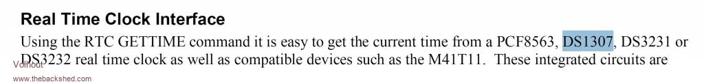

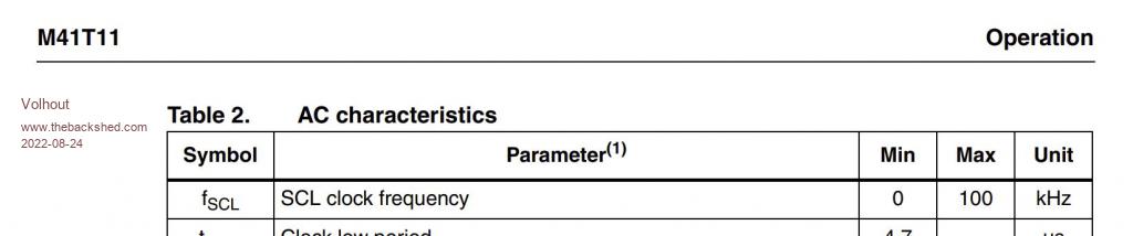

Posts: 5021
Posted: 08:48am 24 Aug 2022
Maybe this is something for the picomite bug list.
The system I2C port needs to be 100kHz -or- the user manual must be adapted.
The DS1307 and M41T11 RTC chip cannot run at 400kHz. It's maximum is at 100kHz
Edited 2022-08-24 18:51 by Volhout

I appreciate your suggestions, but my point is that we have a mismatch between the user manual, that advocates a DS1307, and the firmware that will not work with a DS1307. Geoff and Peter have to align user manual and firmware. Same for the M41T11 chip.
The DS3231, DS3232 and the PCF8563 are fine
Edited 2022-08-25 16:30 by Volhout
