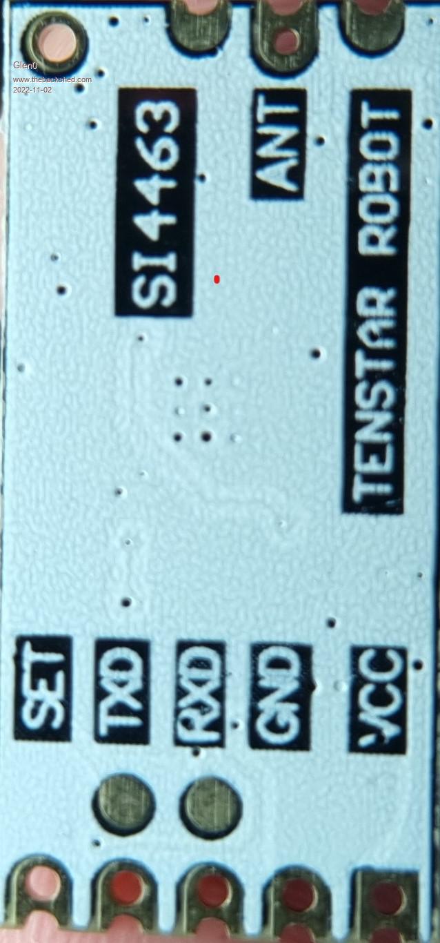

My HC12's have arrived. I tried them out with the code and instructions I found in the "Getting Started with the Micromite" document and the Pico manual, but no go unfortunately.
Two questions/requests
Do these look like the HC12's that should work?
Can someone post
 simple programs for the Pico's. I am of course testing with one pico for the transmitting module and one for the receiver so using the same comm. port/pins will be nice.

No, they are clones.
Are you aware of the thread on the clone problem?
Let me know here if not, and I or another member will link you to it.
It is a multi-page read, but it does go in depth into the issue of clones and why they don't work very well, and usually not at all with other genuine HC12's in the same network.

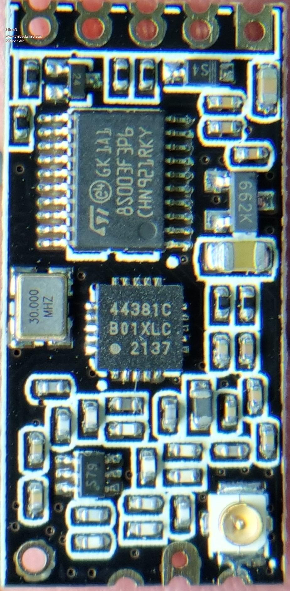

Genuine ones say "HC12" on the bottom silkscreen, along with "www.hc01.com" web address, and the PCB is always BLUE, not black.
You can also tell these are clones by the fact that they are ID'd as TENSTAR ROBOT - that is not the HC company.  Unfortunately, there are A-LOT of clones on the market, and I had to make contact with the HC company with help from others, to buy direct from them.  That way, I know I am getting the genuine article.
There are BLUE ones out there that are also clones.  Complete with all the usual markings on the PCB, which makes it even harder to know what you have got.
One way, currently, is that the board has to be blue, have the HC markings on it, AND must also have the HC logo laser-engraved into the 30MHz crystal package on the top.  If the crystal does NOT have the HC logo lasered into it, the module is a suspect clone.

Re: HC website - NO, and that's the problem.
If you surf on over to their website, you will find it is all in Chinese, with no English option.  That's why most people buy them from eBay or AliExpress, but there is no way to know if you will get a clone or not.
Last time I ordered from HC directly, they had a MOQ of 50pcs, so you have to buy at least 50 if you order from them.  I think that the MOQ came in, along with many other things, cos of the virus.
I do have the genuine article here - flick me an email(I think you have my email) if you want me to sell you a couple.  I don't have a huge number in stock, but I could probably see you right for a small handful depending on what you need.  They are the genuine article sourced from HC though, so you know you will be getting the genuine article.
