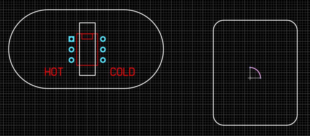

I got Sprint Layout 6.0 a few weeks ago because I know some of you guys use it, But even though it's looking easy to figure out, the documentation does leave something to be desired, and I have some questions Just to start off with,
1. on 2 layer board board when I place a part, will that place a solder pad on both top and bottom? will it automatically plate though the board, so when I solder a part on the bottom of the and get a good connection to a Track on the top side of the board?
2. How do I draw Board shapes and add AC Isolation Slots?, I'm trying to make custom shaped boards for robots
Thank you for any Info

1. It depends on how the item was saved. You might find that some items are saved with the pads on the bottom layer only - it's easy enough to make them plated through pads. There's a box to tick when you highlight the item. I use the second smallest round pads as vias.
You can also highlight individual pads or parts of an object by holding down Alt while you click on the bit you want. This allows you to do things like deleting pads & stretching outlines to make odd sized connectors.
2. There is no slot command. You have to put a row of chain drilled holes on layer O to get a slot.
Boards are always rectangular by default but you can warp them. e.g. draw a rectangular outline on layer O. Now highlight it and you can see the corner nodes and mid-point nodes. You can stretch the mid-points out of position, creating new mid-point nodes on each side as the new position becomes a new node. It's easier to do than to explain. lol. You can have as many nodes as you want AFAIK so the system is quite flexible. You can't have true curved PCBs though AFAIK.
(Incidentally, it's probably better to change the grid to 1mm when messing with the board outlines. That way you end up with true metric sized boards with sensible fixing centres - unlike your horrible US decimal inch system. ;)  More seriously, it makes sense if you want 100mm square PCBs for JLCPCB.)

Further to what Mick said, making LARGE holes or cutouts in your board, is done by drawing the shape on layer zero.  If you wanted a 30mm hole in your board for a huge arcade-style button for example, you draw a circle with the circle tool, on layer zero.

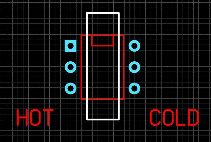

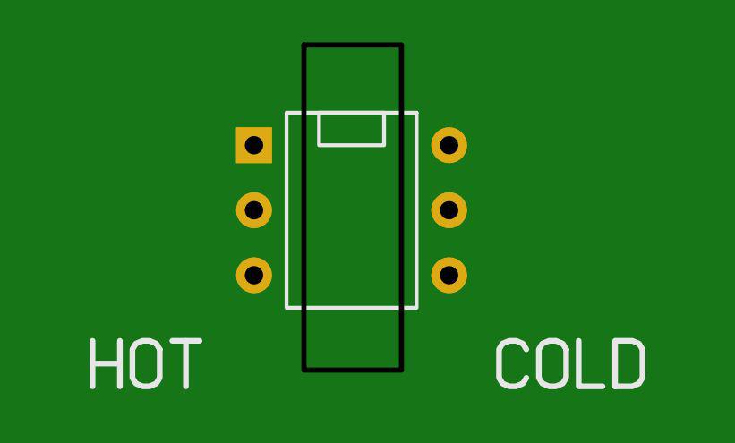

EDIT: VERY quick example of a 6-pin DIL opto-isolator with a slot cut underneath it.  This is a 0.635mm grid, so the slot is 3.8mm wide.
Note the light-blue pads on the opto, meaning this part has plate-through holes, with pads on both top and bottom of the PCB.
A tool I particularly love, is the photoview tool, which is like a cheaper version of the 3D view that some more exotic CAD software can do.  This just lets you see what your board will look like as you go.  The one above looks like this:

  Mixtel90 said  You can't have true curved PCBs though AFAIK.
You can, but it requires much more work then standard square or rectangular.
To make a curvy board, I start with the CIRCLE tool, and draw a circle of suitable size.
Click the circle, drag the node to turn the circle into an arc.
Right-click/Duplicate as needed.
Flip H and V and rotate as needed.
Place till you have the final outline.
Use the track tool to draw lines between the nodes on the arcs.
Posts: 8911
Posted: 03:26pm 24 Sep 2022
Silly me - I've done cutouts with rounded corners the same way. lol
As long as the outlines are on layer O you are fine. I usually put a roughly drawn X inside cutout areas just to clarify - it seems to have worked so far. :)

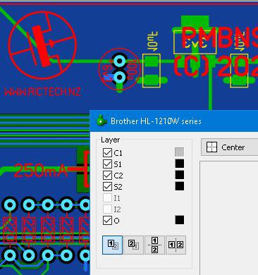

Confused about layer zero; if I draw a white circle, it doesn't show up as a hole on my print-out. I have to use a pad. What am I missing?

Layer zero is not printed, as normally you don't need it to show up in printouts, as it is a machining layer, not really a layer for showing on printouts.
To make it show up when you do prints of your layout, make sure that there is a tick in the "O" checkbox in the print preview window.
Click the printer icon on the top taskbar on SL6, then refer to the checkboxes at top-left of the window:
