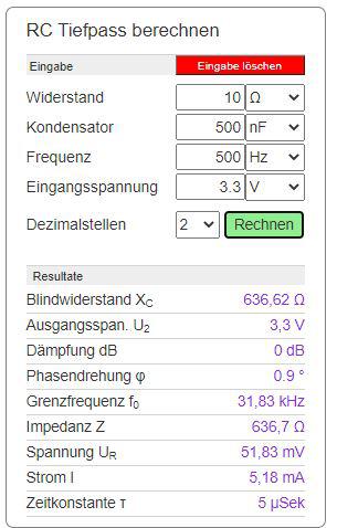

Posted: 12:53pm 28 Nov 2022
  thwill said
  phil99 said  One I have used (from an old microwave oven) was very fussy about the frequency. Quite loud at resonance. Sweep the PWM from 400Hz to 2kHz or so to find the loudest point.
Thanks Phil, but I don't think that is the problem I am trying to solve, I CAN get a buzz out of it using the PWM command but I'd like to get music out of it using PLAY SOUND.
However from the manual my understanding is that PLAY SOUND (and PLAY TONE) expect a "low pass filter" and some sort of amp to be connected to the pins, and tying the buzzer to the appropriate PWM pin isn't going to cut it.
I'm hoping the cognizante will be able to tell me what I need to build ... or conversely tell me I am on a fool's errand.
... it may also be that I am going to have to rewrite my MMBasic music engine to use PWM directly, in which case I assume I am still going to want some sort of "protection" between the PicoMite PWM pin and the buzzer.
in German but I think you ll get it:
RC Low Pass
cheers

Posts: 9407
Posted: 01:07pm 28 Nov 2022
You should have a resistor/capacitor filter off the pin to get rid of the carrier frequency of the PWM. However, you might get away without them - or with just a capacitor - if driving one of the little passive sounders.
The problem is that the sounders have a truly horrible frequency response and are designed to resonate over a narrow range to get maximum beep volume. You'd be far better getting one of the small laptop speakers which, although they are still horrible, at least attempt more than one frequency.

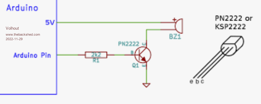

Posts: 6304
Posted: 04:10pm 28 Nov 2022
The data from the Aliexpress page looks to specify a 2700Hz buzzer operated from 2-5Vdc pulling 40mA current. So you need not drive it from a PWM. It will generate 2700Hz if you connect it to 3.3V. And it will draw 40mA.
You only need a IO pin and a FET or transistor to drive it ON and OFF.
Quick check: connect + pin to 3.3V and - pin to GND... and shiver...
Driver circuit (will work with 5V and 3.3V)
Edited 2022-11-29 02:23 by Volhout
Posts: 4412
Posted: 04:24pm 28 Nov 2022
  Volhout said  The data from the Aliexpress page looks to specify a 2700Hz buzzer operated from 2-5Vdc pulling 40mA current. So you need not drive it from a PWM. It will generate 2700Hz if you connect it to 3.3V. And it will draw 40mA.

Posts: 4412
Posted: 11:31pm 28 Nov 2022
OK, so they are active buzzers and they work fine (with PWM) using Volhout's circuit from above with the PN2222 swapped out with the BC547s that I have.
I even played a 2-channel version of "The Entertainer" on a pair of them using the PWM command, it was an experience not to be forgotten .
But I get Sweet FA (with or without the low pass filter from the PicoMite manual) if I use the same setup with OPTION AUDIO, and PLAY TONE or PLAY SOUND. What detail am I failing to grasp ?
