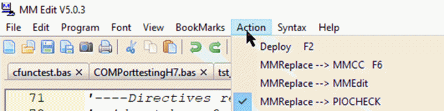

The MMEdit Actions Menu
The MMReplace --> MMEdit option will load the process code back to another Tab in MMEdit. Comments will be preserved.
The MMReplace --> MMCC option will load the processed code directly to the Picomite via MMCC, comments will be removed. If any syntax or out of range errors in the PIO source are detected the code is not loaded and a window will open to show the errors.
A third option is added to the MMEdit5 Action menu

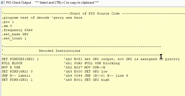

MMReplace --> PIOCheck
This will not load to either MMEdit or MMCC, but will only process the PIO source and display the result in a window. This is meant to help in development of PIO code. The window will show the resultant generated PIO code and MMBasic commands as well a display any syntax errors or out of range parameters detected.

When the output is sent back to MMEdit all comments are preserved, so you can see the whole thing.You could then send this to MMCC from MMEdit.
When the output is sent via MMReplace --> PIOCHECK a window is opened that shows only the PIO output, displaying any errors. You would use this the verify the PIO source will compile without errors before attemting to load it.

? Now run the MMReplace --> PIOCHECK Action. You get the window shown below
Highlight the decoded instructions and use CTRL+C to get them into the clipboard for windows.Linux is right click and copy.
Paste them below the .decode directives. Comment out the .decode directives.

? Now run the MMReplace --> PIOCHECK Action again. You get the window shown below
If its error free you are ready to try it on the Picomite. Use the
MMReplace--> MMCC Action to load it.
