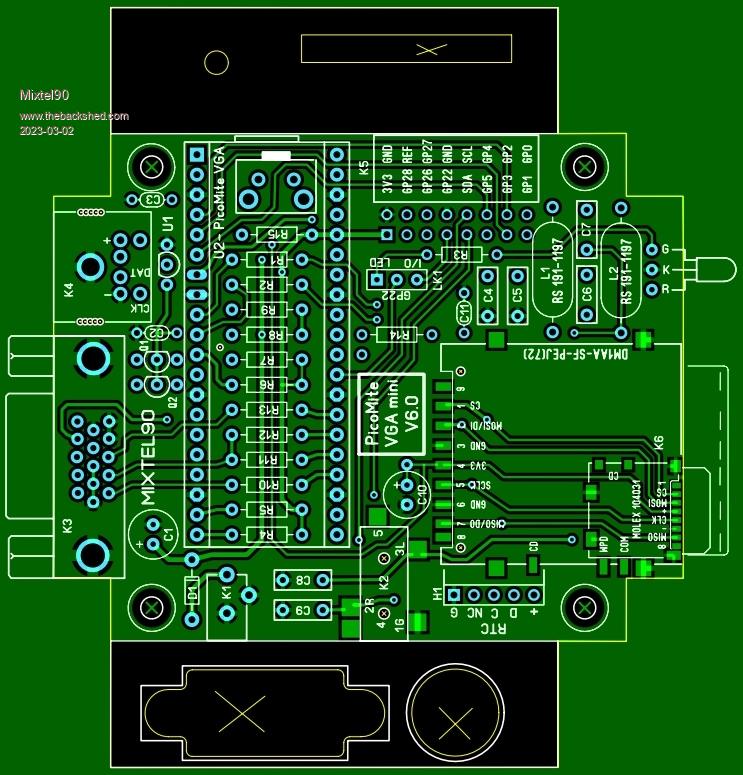

I've kept going back to this for a while and this is the latest incarnation, Version 6.
It still fits the same 90x70x28mm case from ebay etc. but now it has:
Linear regulator by default.
Volhout's auio filter.
Choice of standard or micro SD card.
A 2-colour LED (see below).
> There are now no ebay modules used, it's all standard components.
> The I/O connector has been reduced to 16 pins (8+8) as that uses up all available spare I/O on the PicoMite. This is a common size for ribbon cable.
> The LED is two colour. GP22 can be switched to be used as an I/O pin or to control the green element of the LED. The red element is connected to 5V via a resistor by default (Power On indication) but this can be disconnected and a wire used to connect the TP directly to it. In this case it replaces the heartbeat LED on the PicoMite because its Vf is lower.
> The PicMite has been rotated through 90 degrees, so its USB connector could be made accessible through the side of the case. To make this work it would be better to use shorter headers than usual.
> Almost all the resistors are beneath the PicoMite to keep things compact, but they are reasonably well spaced apart.
If the standard SD card option is used then it should be fairly easy to assemble by anyone who can solder.

A time-warp board, judging by the silkscreen!
Looks good.

Mick,
schematic available?
If so, would you ship one PCB to Germany?

I'll be doing a construction pack for this one, complete with Gerber files. The whole thing is on a single 100x100mm PCB, cheapest price from JLCPCB. It's probably cheaper for you to get your own made than it is for postage!

I have not yet been able to test the VGA software version because I run into the staggered pin assignment of a VGA connector.
I mostly use breadboards with the RP2040 or Raspberry Pi Pico and this pcb meets my expectations.
Could be a small problem and not just for me I think soldering the smd connections for the micro sd card?
But a micro SD card print with pin connection row could be added to that in existing SD card space, such as this https://www.ebay.com/itm/201414997418 and then the pins at the bottom and are also on AliExpress readily available and work great with my plates.
A row of extra bus pins for I2C for, for example, a small Oled screen or I2C sensors would be a nice addition.
Jan
Posts: 7815
Posted: 07:27pm 02 Mar 2023
You don't need the micro SD socket at all. In fact, you don't need either SD card socket for it to work. :)  The standard SD card socket is actually quite easy to solder as it has locating pegs to hold it in position - as does the audio jack socket. I only included the micro SD card socket for my own use. You can, of course, fit the standard SD card socket and use a micro SD card adapter in it if you only have micro cards. :).
I can't really add options to add anything else inside, but I'll have a look at addding a pair of I2C pads somewhere.

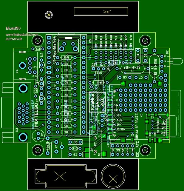

Quite a major re-hash, hence the delay. :)  Many of the changes are subtle, but there are some pretty obvious ones.

Looks a bit confusing now. What are the extra holes for? Experimental field?
Does it make sense to do without an external voltage regulator?
With the SD card, RTC and LED, it can add up to a few mA.
Posts: 7815
Posted: 04:08pm 07 Mar 2023
The "sea of holes" is for you to play with if you decide to use the micro SD card or neither. The external linear regulator is completely optional. It will be used by default but you are free to use the SMPS if you prefer (but there will be noise on the audio). There is enough spare current for the RTC and SD card. The LED is only running at 3-4mA for each colour.
Just a bit of explanation of the changes.
I rotated one of the inductors to get rid of magnetic coupling between them, reducing crosstalk between channels.
I've been asked in the past about including a "sea of holes" in my designs for those who like to experiment. As the SD cards are no longer as important as they used to be I decided to steal some of that board space.
I spread Q1 and Q2 out a bit to make assembly easier.
Having R15 offset from the others annoyed me. That led to some rearrangement of the resistors, together with getting rd of a couple of layout idiocies.
Pads have been added to access the I2C bus from inside the case. They may be useful for something.

I've been fitting and measuring with my SD card holder. If I want to mount the SD pcb of (18x18) directly on the PCB then L1 is in the way, but that can be remedied by placing the pin holder between the PCBs or L1 at the bottom of the PCB?
Are the various separate islands fully metalised?
And the lettering at the components could be a bit better like d g s or Inp gnd Out and a k and I haven't figured out yet what the part is under Raspberry Pi Pico at usb?
And I've looked at the schematic, which hasn't been updated yet for this pcb, so it's not easy to check, but I don't think it's the final version yet and well on its way?
