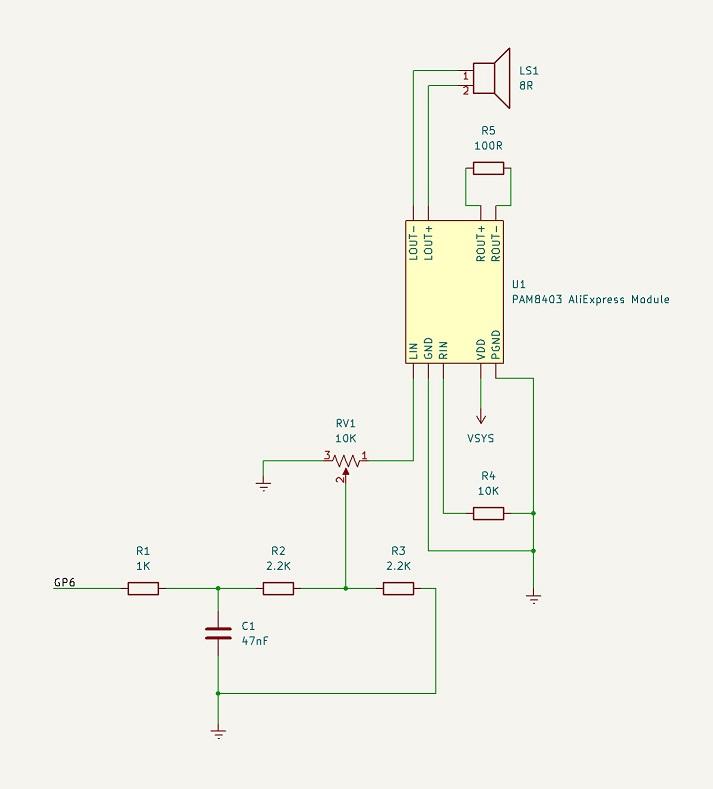

Hi folks,
I'm still struggling with this, both with ticking and hissing when using PLAY SOUND:
   https://www.youtube.com/watch?v=4fvh2d3T42U
1. It's not the SD card, it sounds the same with and without the LCD/SD module attached.
2. There is more hissing when running from the battery than from the Pico/USB.
3. I can "hear" the heartbeat LED flashing as a hiss.
4. The output from PLAY WAV is acceptable, no ticking and not significant hissing.
I'm looking to remove/reduce the tick and the hiss, I realise the former may be something that if completely fixable will require me to improve the software, but I'm guessing the latter is a matter of scattering capacitors/resistors/ferrite beads like confetti .
And no I haven't done, or understood everything that has been suggested, I'm even more out of my depth with analog than I am with digital electronics.
Here is my current schematic:
The low-pass filter is the original PicoMite one, I've also tried the one in the more recent PicoMite manuals (4.7mH/2.7nF/33nF/68nF) on solderless breadboard and it didn't seem any better .
What I'm planning to try next:
1. Try a soldered version of the improved filter.
2. Put both a 100uF electrolytic and a 0.1uF between power and ground on the main PicoGAME LCD after the battery switch - which I think is what @Turbo46 is saying ?
3. Update my music engine to remove redundant calls to PLAY SOUND when two consecutive "notes" are the same.
Any other specific suggestions are welcome,
