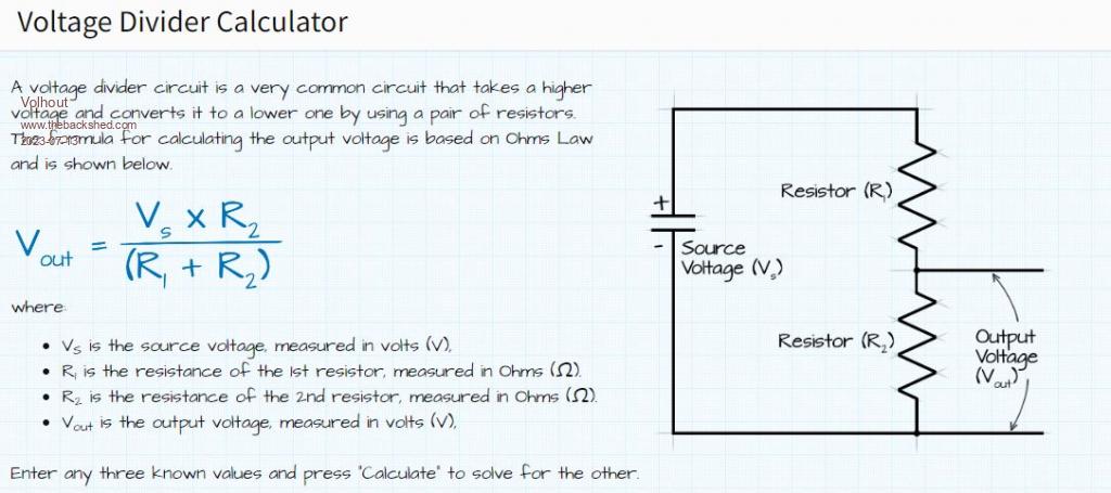

I am not sure what your intentions with the explore64 are, but if you want to monitor a 12 cell battery, the Explore64 is well equipped wit many ADC's (analog inputs, that can measure voltages). Only they can measure between 0V and 3.3V.
Your battery is (maximum topped up) 12x2.4V = 28.8V.
Using this formula
Connect "Output voltage" to the Explore 64 (i.e. pin 8) and "source voltage" to the battery. Connect the batter minus pin to the explore 64 "ground" pin.
You can calculate the attenuator to needed to connect 28.8V to a 3.3V input.
Let us assume you want to measure up to roughly 30V, then resistor values could be
R1 = 10k  (common available value)
R2 = 1.2k (common available value)
Vout would be (10+1.2)/1.2 = 9.333 times lower than Vsource.
The 3.3V measred from the Explore 64 would then in reality be 30.8V (9.333 * higher)

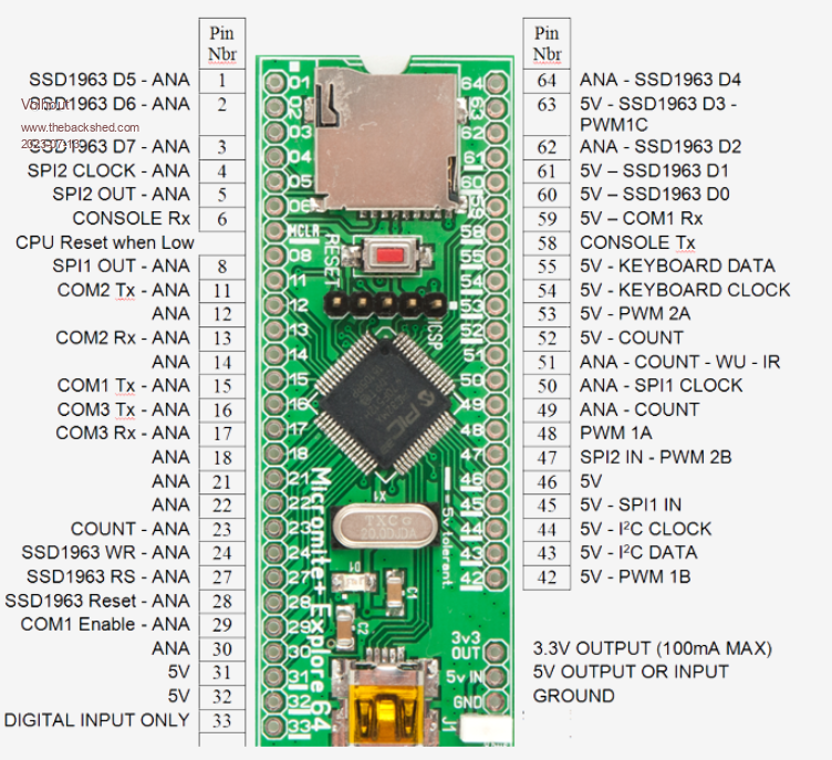

In case you wan to constantly measure all 12 cells: repeat the above circuit 12 times, using 12 different pins on the explore 64 (they must be marked "ANA"" and connect the 12 "source voltage" pins to 12 taps on the battery. I used the pins on the left side with numbers 8,11,12,,,,,,,23.
This is the connection diagram of the explore64 I used
The program would be:
Setpin 8,AIN
Setpin 11, AIN
etc...
Setpin 23, AIN
Voltage1 = pin(8) * 9.333
Voltage2 = pin(11) * 9.333
etc...
Voltage12 = pin(23) * 9.333
Cell1 = Voltage1 - Voltage2
Cell2 = Voltage2 - Voltage3
etc...
Cell12 = Voltage12
Hope this helps
P.S. This battery can deliver serious energy into the measurement circuit (Explore 64 and connected PC). To minimize risk for damage, please connect the ground of the Explore 64 to the minus pin of the battery using a 0.5A or 1A fuse (i.e. cartridge fuse). In case there is a problem, the fuse will blow, and not the PC. The measurement inputs themselves do not need protection, the 10k ohm resistors limit the currents sufficiently.
P.P.S. If you can, try to buy 1% accurate resistors. This will give better results than the cheap 5% resistors. Alternatively you can "calibrate" each measurement channel. In that case the attenuation for each input woul be different (i.e. pin(8) * 9.35, pin(11) * 9.40, pin(12) * 9.32 ).
