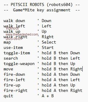

as I allready posted:
  Martin H. said  @Volhout
Replace this Block and we have a Start Menu without the "Controlls" Entry.
Sub show_intro
 'load screen
 FRAMEBUFFER write l:CLS :FRAMEBUFFER write sc$
 Load image path$("images/introscreen.bmp"),0,10
 FRAMEBUFFER write l: fade_in: :FRAMEBUFFER write sc$
 Local integer puls(11)=(0,1,9,11,3,6,7,6,5,11,9,1),t,t2
 Local Message$(4) length 40
 'set Map to 0, Menu State to 1
 Message$(1)="...use UP & DOWN, Space or 'Start'      "
 Message$(2)="   ...use LEFT & RIGHT to select Map    "
 Message$(3)="  ...use LEFT & RIGHT cange Difficulty  "
 Dim DIFF_LEVEL_WORD$(2) length 6 =("EASY  ","NORMAL","HARD  ")
 Map_Nr=0:MS=1:Difficulty=1
 ' start playing the intro Music
 Play Modfile path$("music/metal_heads-sfx.mod")
 show_menu 1
 'Display Map Name
 Text 9,70,UCase$(map_nam$(Map_Nr))
 '--- copyright notices etc
 Text 0,224,Message$(1),,,,col(3)
 Local msg$ = String$(36,32)
 '  Cat msg$, sys.get_config$("device", "Generic " + Mm.Device$) + " - "
 Inc msg$, "Original Game by David Murray - "
 Inc msg$, "Port to Mite and MM-Basic by Volhout, Martin H and thebackshed-"
 Inc msg$, "Community - Music by Noelle Aman, Graphic by "
 Inc msg$, "Piotr Radecki - MMBasic by Geoff Graham and Peter Mather "
 flip=0
 MT=0
 'check player choice
 kill_kb
   If flip=0 Then Inc MT:If mt>Len(msg$) Then MT=0
   tp$=Mid$(msg$,1+MT,41)
   If t2=0 Then 'once every 4 cycles
     k$=read_input$()
     If k$<>"" Then
       Play modsample s_beep-2,4
       If k$="down" Then Inc MS,(MS<3)
       If k$="up" Then Inc MS,-(MS>1)
       If k$="use-item" Then
         Select Case MS
           Case 1
             FRAMEBUFFER write L:fade_out:FRAMEBUFFER write sc$
             Exit 'intro and go on with the Program
           Case 2
             'select map
             kill_kb
             Text 0,224,message$(2),,,,col(3)
               k$=read_input$()
               If k$<>"" Then
                 If k$="left" Then Inc Map_Nr,-(Map_Nr>0)
                 If k$="right" Then Inc Map_Nr,(Map_Nr<13)
                   Text 0,224,message$(1),,,,col(3): Exit
                 EndIf
                 Text 9,70,"                "
                 If LCD_DISPLAY Then FRAMEBUFFER Merge 9,b
               EndIf
               Pause 200
             kill_kb
           Case 3
             'select DIFFICULTY
             kill_kb
             Text 0,224,message$(3),,,,col(3)
               k$=read_input$()
               If k$<>"" Then
                   Text 0,232,"      "
                   Exit
                 EndIf
                 If k$="left" Then
                   Inc Diff_Level,-(Diff_Level>0)
                 EndIf
                 If k$="right" Then
                   Inc Diff_Level,(Diff_Level<2)
                 EndIf
                 Text 0,232,DIFF_LEVEL_WORD$(Diff_Level)
                 Load image path$("images/face_"+Str$(Diff_Level)+".bmp"),234,85
               EndIf
               Pause 200
             kill_kb
            End Select
       EndIf
     EndIf
   EndIf
   show_menu MS,col(puls(t))
   Text 8-(2*flip),0,tp$,,,,col(2):flip=(flip+1) And 3
   Inc t: t=t Mod 12 'color change
   Inc t2: t2=t2 Mod 3 'reponse time keys
   Pause 50
 Play stop
End Sub
 'remove duplicate keys and key repeat
Sub kill_kb
 Do While read_input$() <> "" : Loop
End Sub
 'start menu selection list
Sub show_menu(n1,FC)
 Local tc,BG=0,f2=col(10)
 tc=f2 :If n1=1 Then tc=FC
 Text 32,30,"START GAME",,,,tc
 tc=f2 : :If n1=2 Then tc=FC
 Text 32,38,"SELECT MAP",,,,tc
 tc=f2 : :If n1=3 Then tc=FC
 Text 32,46,"DIFFICULTY",,,,tc
End Sub
We might use the "Select" button /ESC to quit the Game in the StartMenu, if nessesary
