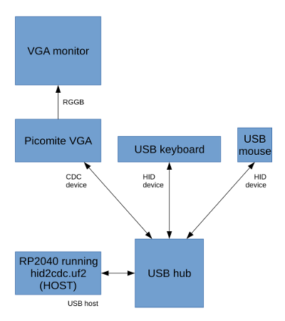

the upstream port (on the flying lead) of the hub needs to connect, via an adapter, to the pico that is running usb2cdc.uf2. that pico also needs to have a 5-volt power supply feeding into VBUS (pin 40). this 5-volts is what powers the upstream pico, the hub, and all downstream devices attached to the hub.
into the downstream ports of the hub, you need to plug in:
1. a VGA picomite
2. a USB keyboard
3. a USB mouse (optional)
the VGA picomite needs to have a VGA monitor attached to see what is going on. if all is working, when a key is pressed on the USB keyboard, something should be displayed by the VGA picomite on the VGA screen... what exactly, i am not sure!
the upstream pico is effectively acting like a PC host would, the software of which:
A. reads keyboard scancodes from any attached USB keyboard, then,
B. converts those scancodes into ASCII characters (and VT escape sequences for function keys), and,
C. sends the resulting ASCII characters and VT escape sequences to any attached USB CDC serial device.
ultimately, i foresee the usb2cdc.uf2 also translating mouse movement codes received from any attached USB mouse into VT200 mouse escape sequences. this will allow a CMM2 (or PICO, with peter's consent) to have mouse functionality within the editor to the extent already supported when a terminal emulator is used.
