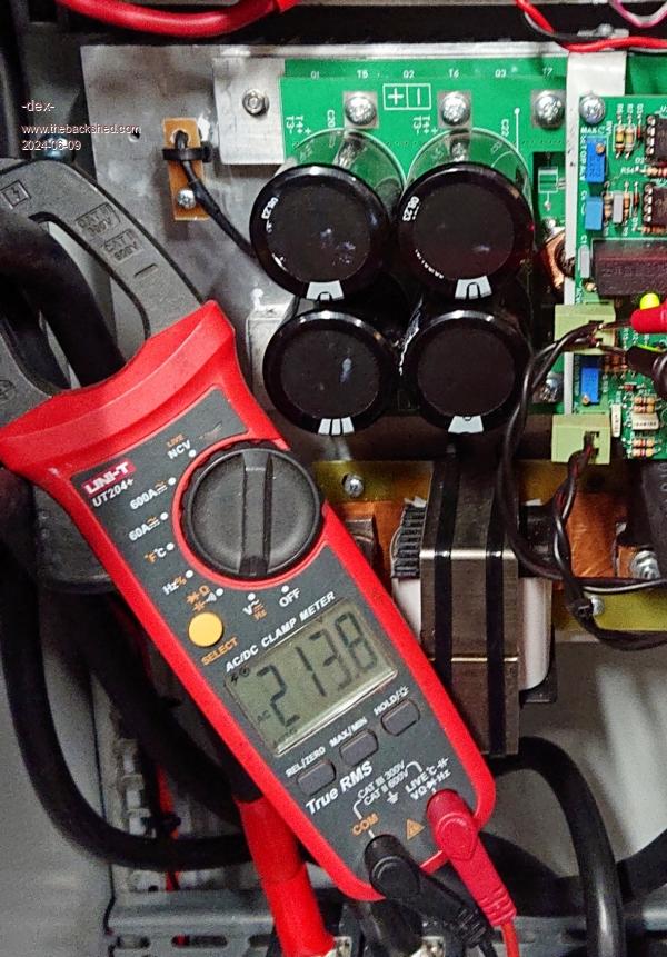

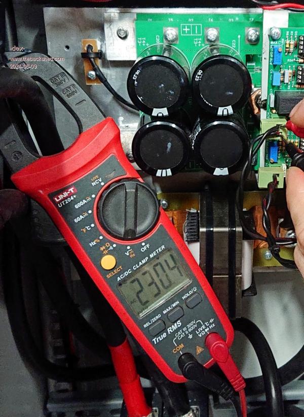

Hi Dex I was waiting for you to do the first test, "I suspect that if you measure with an AC RMS voltmeter at the two pins (J2) feeding back the AC output right at the Nano control board it will have exactly the same voltage reading of 230.5 give or take half a volt for the instance of no load and ~8A load." Please measure the AC volts at the connector with an RMS meter for no load and with an 8 Amp load 8 is not critical 6-12 amps will do higher is better. What are the 2 AC voltages ? Thanks for the pictures and wiring diagram, do you have the control card just some millimetres above the main Power Fet PCB ? Re your question "RV1 behaves correctly, I can change the input voltage with it. But why does the system do nothing to change the SPWM % when the AC voltage drops?" That is what these tests will hopefully determine. The system only has one AC signal source which is then converted to a DC level to determine what % to use, does the AC voltage change at the connector or stay the same? Edited 2024-06-09 18:10 by wiseguy If at first you dont succeed, I suggest you avoid sky diving.... Cheers Mike |

-dex- Senior Member ![]() Joined: 11/01/2024 Location: PolandPosts: 101 |
Here they are. No load ![]() ~8A resistive load ![]() |

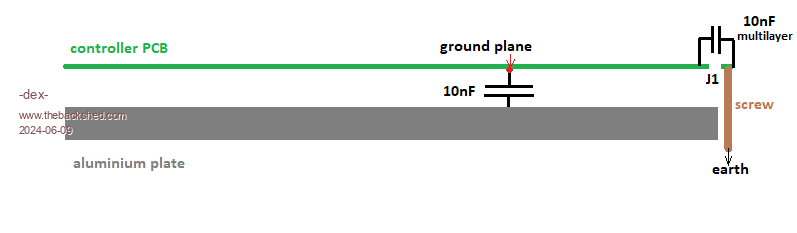

I can add an aluminum plate underneath the entire controller board. Please clarify what kind of grounding you mean. Casing is earthed, so the heatsink and controller holder also have casing = earth potential - red arrows. Should the aluminum plate have the "-" potential of the battery or the earth potential? And there's one more thing that makes me wonder. If the noise signals the controller to reduce the voltage at the output, I should notice it in % SPWM, and according to what the LCD shows, it remains unchanged. ![]() Edited 2024-06-09 19:57 by -dex- |
wiseguy![]() Guru ![]() Joined: 21/06/2018 Location: AustraliaPosts: 1206 |

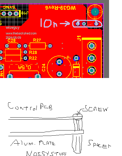

I would be happy for either or neither it does not have to be earthed. I would put it to ground if I had to chose. I believe that KeepIS put it to B-. The plate does not have to be earthed to ground or B- but it must be connected to the PCB groundplane area (through the 10n capacitor you need to fit). Next step is to put the capacitor of at least 10nF - preferably a multilayer ceramic, from the PCB ground-plane pads to the screw solder pads just near J1. The screw should have a metal spacer to the plate once the plate and the ground plane and sensitive nodes are at the same "noise" potential I believe it should cure your problem. Edited 2024-06-09 20:02 by wiseguy If at first you dont succeed, I suggest you avoid sky diving.... Cheers Mike |
Before I do anything, I want to be sure that I understand what I read, and I'm not sure of that. Is this what it's supposed to look like? ![]() |
It is easier to write than draw the picture. Make a plate of aluminium same size as control PCB Screw aluminium plate where pcb is now, use spacers to screw the plate to the existing spacers (I hope you have 4 spare spacers female to male). Now solder 1 and only 10n capacitor on PCB pads just next to J1. Now screw control PCB onto the spacers sticking up from the aluminium plate. Put wires/plugs back to control card and retest. I will draw a picture but not possible for about 1 - 1.5 hour. Edited 2024-06-09 21:10 by wiseguy If at first you dont succeed, I suggest you avoid sky diving.... Cheers Mike |
I got my 4 year old assistant to draw this......... ![]() What can I say...... drawn with a fingernail on a touch pad.... If at first you dont succeed, I suggest you avoid sky diving.... Cheers Mike |
