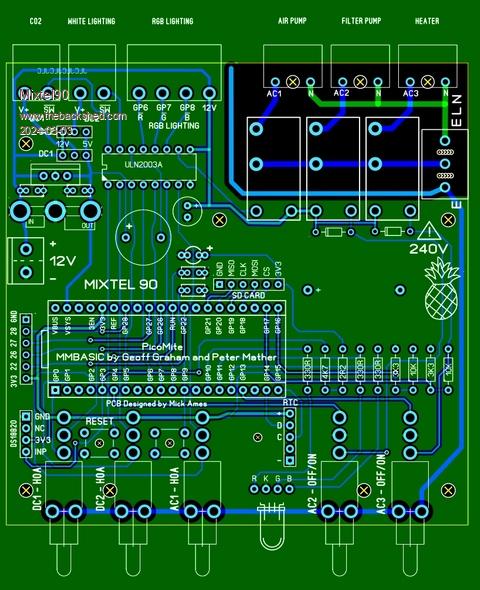

This is my current project between other things. :)
It's a board (designed to fit a CMM2 case) that can be used for general purpose control.
2 DC outputs with ON-OFF-AUTO switches (selectable for 5V or 12V)
-- (intended for white lighting and CO2 dosing solenoid
3 DC outputs
-- (intended for PWM LED lighting)
1 AC mains relay output with ON-OFF-AUTO switching
-- (intended for airstone pump)
2 AC mains relay outputs with OFF-ON switches and a crude form of relay coil monitoring
-- (intended for filter pump and heater)
1 input for DS18B20 temperature sensor
Socket for RTC
Socket for SDcard reader
Audio buzzer
RGB indicator LED on front panel
The idea is that it gets rid of a lot of 13A plugs & sockets, giving easy control of things (like shutting off the filter pump for cleaning) without bothering about wet hands. All switching is at 3.3V or 12V and all the toggles are connected to mains earth.
I couldn't find small mains outlet connectors so I settled for 3.81 pitch pluggable terminals as these are not easy to touch. With hindsight I should have put links on the PCB to disable the relay for any unused mains output, but never mind. The plugs for the mains sockets are screwless types as the wire exits from the back. A bit of heatshrink sleeve should make them completely touch-proof, if a bit lacking in cable retention!
As you can see, this could be used for all sorts of things where you just want a bit of a control system. It wouldn't take much to modify the design if you needed auto control of the two switched mains relays, but I deliberately wanted them safe. The tank can be run even without the Pico if necessary.
Using a Pico W in this would allow me to update the program over Telnet, so no access is needed to the USB connector once up and running. That's one less hole in the box.

The PCB has a fancy trick up its sleeve. If you fix it into a CMM2 case using just the fixing holes underneath the switches you can then mark/drill all the other fixing points and access holes for the buttons. All the mounting spacers will line up automatically then. :)  It was cheaper to do this than make a proper size PCB.

Why are there diodes at the coils of the 2 rightmost relays ?
You connected pin 9 of the ULN2003 to +12V, so the diodes would not be needed.
EDIT: Oops... these relays are controlled by switches. Sorry...
Edited 2024-03-04 20:12 by Volhout
Posts: 8911
Posted: 10:11am 04 Mar 2024
Those two are directly switched by the RH OFF-ON toggle switches, not via the ULN2003. I only used relays to give isolation from the toggles, which are going to be operated by wet fingers!

Posts: 8911
Posted: 06:19pm 07 Mar 2024
Finally, some more info. :)
Here's the circuit diagram:
circuit.pdf
And here's the Gerbers:
aq-ctrl.zip
If anyone wants to modify it for their own purposes, Here's the SL6 file so you can edit the layout yourself:
aquarium control SL6.zip
This needs Sprint Layout 6.0.
The PCB is 100mm square so that it is in "the cheap zone" for JLCPCB.
There is no manual or BOM as such. There are a few details on the circuit.

For us, mainland Europeans, it looks very strange to see a design that does not have a mains fuse. I know in UK you have mains fuses in the power plug, but these may be rated higher that the PCB traces can handle (or the relay contacts for that matter), so you would need to have a fuse rated for the product...right ? Like a 2A/3.15A/4A fuse.

Why doesn't relay one have a diode accross the coil ?
atmega8
Joined: 19/11/2013
Posts: 738
Posted: 11:01pm 07 Mar 2024
  palcal said  Why doesn't relay one have a diode accross the coil ?
The Diode is in the ULNxxxx
Posts: 8911
Posted: 11:08pm 07 Mar 2024
Volhout:
I have a 3A fuse in the plug. :) I could use a 5A (no bigger) - the tracks would just about take it for a short time. The relay contacts would have no problem. If I was fitting a fuse I'd probably use a panel-mounted holder anyway as it's easier to insulate with a boot or heatshrink. It would have been a better design to include a fuse at the PCB but I ran out of usable space anyway. The total load is about 27W with the heater and pump on so even a 3A fuse is overkill. A 125mA type T would probably be fine.
Palcal:
That relay is driven by the ULN2003, which includes suppression diodes up to 12V. The two relays that have diodes are directly switched by the right-hand two toggle switches. I probably didn't need those diodes but I thought what the heck. I might want to drive them from transistors sometime.

The circuit states that all switches are down for normal operation. In actual fact they are normally up. That wasn't an error on the PCB layout, it was me not thinking straight when I drew the circuit. :)  This arrangement is because it's easier to press the little toggles down, into the safe/Off position, than switch them up. This is opposite to the normal UK arrangement, but in this case the US system works better.

Things I had "fun" with....
1) The white tank light
This is a 5V bank of LEDs, sealed, with internal resistors that I can't get at. When using a ULN2003A with PWM to drive them there is far too much voltage drop to get a decent light. Inside the controller they are powered from the 5V supply. I've improved them *a lot* simply by connecting a mosfet in parallel with that channel of the ULN2003A, which is now not doing much. The difference in light output between PWM max and switched to full isn't worth bothering about.
2) The stability of the 5V rail leaves a little to be desired.
The switcher (from the main 12V supply) is supposed to be 4A rated but I think it needs a minimum load to be happy. Putting a load resistor on seems to have helped.
3) The connectors for mains voltage devices (heater & filter pump)
These are actually incorrect and there is a risk of shock if they are unplugged. You do need small fingers though. Unfortunately I couldn't fond PCB mounting female connectors small enough. The cable-mounted female connectors were intended to have heatshrink shrouds to give some cable protection and overall insulation but I discovered that I have no heatshrink that will do the job. :(
4) The Pico W
This has been driving me nuts. Eventually I swapped it for a YD-RP2040 and gave up on the wi-fi side for the moment. It's far too unreliable, with all sorts of reboots and sometimes stupid watchdog timeouts for apparently no reason. Even telnet was almost useless until disabled the HTTP server. The latter crashed most of the time if I sent it messages from the PC browser. At least I allowed a RTC connector on the board. :) I have to set times etc. using a USB lead, but that rarely changes.
5) The RGB LED
Not really a problem, but the three colours have different sensitivities so using max PWM on all three doesn't give a sensible white. I got round it very easily as I wanted a dim green for normal running and the blue was too bright so I used PWM on those two and trimmed things.
6) I squeezed a mains fuse in, adjacent to the board and under its own cover. :)
Then there was fun with the CO2 generation before I eventually gave up and bought a Sodastream cylinder, an adapter, a proper regulator and a solenoid. It's worth doing it that way and I can now tune it down to one bubble per 5s, which is very low. Time switching is automatic, of course.
Water quality is now good and the system seems to be cycled ok so I'll be putting fish in very soon now (possibly this week).
