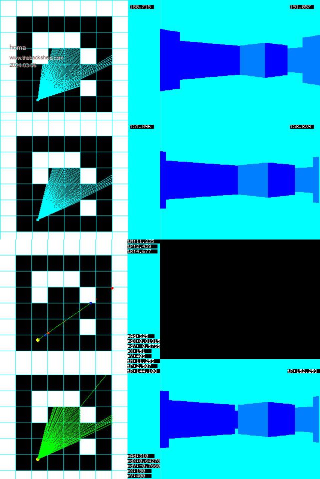

Posted: 06:30pm 05 Mar 2024
Hi Martin,
the graphics look impressive , but I don't think you can get the textures that clean with the dithering.
But my interest is on the rise.
Reducing the viewing angle, and therefore the beam tracking, gives the biggest gain.
Then I did a rebuild down from my memory for speed reasons. This resulted in the version with the visualisation. Here you can see which vertical and horizontal lines are hit by the visualisation beam.
@martin: You have to check whether the horizontal or vertical ends first ... but it takes place in one loop.
A very small tweak compared to the first version. But the throw of the first version was quite okay! The rest of the optimisation doesn't help.
However, I have encountered new problems with the optimisations. See the pictures.
If you're interested in my wild developer code with comments, just let me know and I'll upload it.
Would a routine in CSUB really improve the speed?
Can I access the values from there like mapW()? In other words, just pass the angle of the visible steel to be checked to the function, the function will find the GLOBAL variables and can work with them, and then just return the data for drawing? (And later the tile hit for the matching texture?!)
How and where can I start learning CSUBs?
