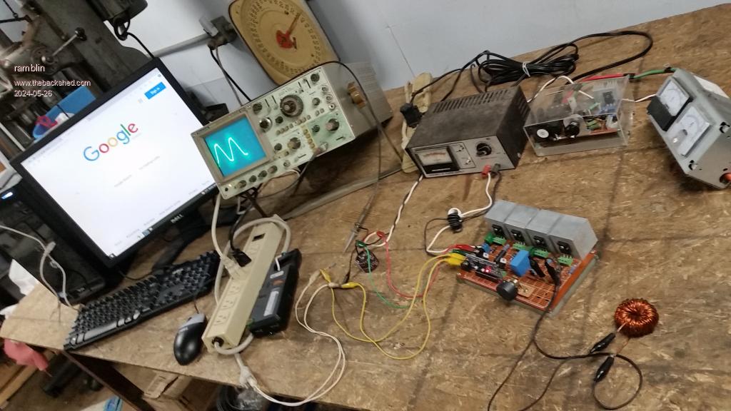

ramblin
Joined: 26/03/2024
Posts: 39
Posted: 10:46pm 09 May 2024
  nickskethisniks said  I can be wrong, but A quick look at the  bottom of your PCB and the position of your gate resistors/components indicate wrong connections,
Just about everything I posted before WAS wrong and I have not found a way to delete it. I have everything now exactly as the example "wiseguy" posted for me. The only changes I made are noted in my last post. I`m sure I have it all wired correctly now. I get good results up to 150vdc input.

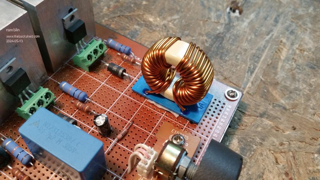

Can you post a picture of the inductor you used?
I can't believe changing the resistor will do much at this point.

Posted: 03:40pm 12 May 2024
  nickskethisniks said  Can you post a picture of the inductor you used?
I admit I don`t know a thing about chokes. Bought this one because it will handle 10 amps and was rated 3.3mH. Didn`t know how to hook it up either. Got only 1 side wired in series now. Tried wiring the other side in with jumpers and also bifilar (that totally changed the waveform). This choke is probably wrong. I could make about what ever I need as I got a lot of small ferrite torrids. I just know as I turn the AC voltage higher,pin 15 decreases in voltage till the board drops out.

Posted: 08:12pm 12 May 2024
It looks like you have a common mode choke, this one will have a very low saturation point/current, they can't store a lot of energy and this function is what you want. So this would probably mean why you are blowing up mosfets. Saturation means no inductance and so just a piece of wire, and high current peaks thru your mosfets as result, because of the 2,2uf on the output, this forms a very low impedance/resistance for the 10khz H-bridge output.
Find something with iron powder or better sendust material, or gapped ferrite cores.
It has a lot more windings, 100windings are very common most of the time and they can store energy, crude said to fill the gaps of the pwm.
Most info on this site about inductors are in the inverter or mppt controller threads, but the used inductance is much lower.
This manufacturer has lots of goodies:
https://www.micrometals.com/
For example MS-184075-2 is a common used core material used for this kind of application, although 10khz is low and you might better of with a gaped silicon steel core, most often used in grid tied inverters.
We would need some numbers to help you make a decision, I think voltage/current output and switching frequency are the mean parameters we need to calculate something for you.
Or you said earlier you have some things laying around, look for some cores in a scrap bin and post some pictures, maybe there is something usable.

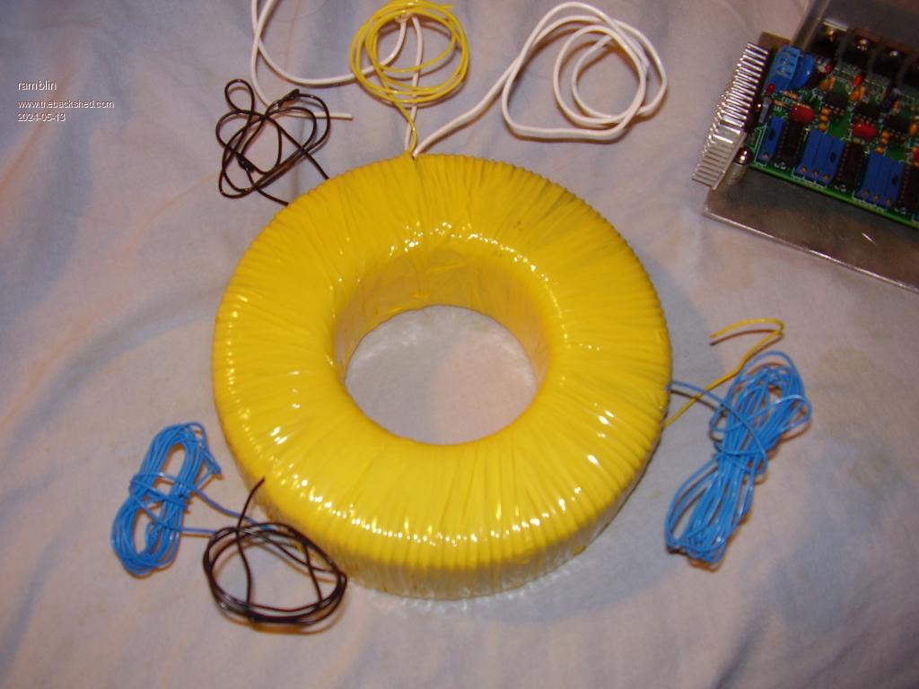

Posted: 12:48am 13 May 2024
I knew I messed up on the choke. With that explanation I see how bad. Most of my surplus are going to be ferrites (lots of ferrites) about the same size as pictured now. But I do have these big ones. (2) 18 ga. steel, 150 strips each, insulated on 1 side, at 1.5 lbs apiece.   And this Micrometals, T650-52 powdered iron toroid.  On a chance it could be used as is, Its wrapped 1st with 130 turns of 16 ga. solid copper, silver plated, teflon coated wire. 2nd wrap is (3) evenly spaced (120deg.) of 20 ga. solid copper, silver plated, teflon coated, 41 turns each (could be tied together) for total 123 turns.

Posted: 02:20am 13 May 2024
That T650-52 core should work ok, try 10 turns of suitably thick copper wire for the primary current you are expecting, 10T gives approx 40uH. Leave the other wires there disconnected if you want to use them for some other purpose.
Mike
nickskethisniks
Joined: 17/10/2017
Location: Belgium
Posts: 490
Posted: 04:49am 13 May 2024
That 650 core gives 405nH/n^2, formula is L=405 X n^2
130 windings will give you almost 7mH, 82 windings wil give you 2.7mH
Inductance will drop a bit when loaded but the core you have is a monster so this will be peanuts.
If your not rewinding it, you could do like mike suggested, wind over the existing windings or use 82 (41+41 in series) windings this will be good for testing. Later on you can try something different this will have probably higher  no load losses Vs a smaller (optimised one)because it's 5kg.

This is the post I been wanting to write. I now have my inverter up and running with no issues with just a few minor changes. I have a many continuous hours on it running PCs, floodlights, motors, drills and just about anything else I can find to try. I seems, my limitations are due to my own experimental generator which hasn't performed as expected. The best coil configuration to get me to the 175-185 window I need is coming up a little short. On average about 170vdc. That conversion only yields about 108-110vac which is about as high as I can turn up the voltage control before the EGS shuts down and blinks undervoltage. As long as I leave it there, I can do about anything I want as long as I add in coils as I add load. Back when I was testing the gen with "dirty" AC I could get much higher voltage out of the same configuration, but I was using AC run caps on the combined output. Now, with a 1000uf cap on my DC output I will see well over 200 but in the end 550hz @170vdc will get you aboue 108vac. I just don`t see any way around that and may have to just live with it. It is very stable though.  I`ve tried everything to trip it up but it just keeps on running. If I carelessly add load without increasing power my voltage will drop and at a point the EGS will shut down. No more burning up fets. Nothing even get warm considering its all wired up with light, cheap jumpers.  Several here warned me of this board's limitations. A few had doubts it would even work. I like what Murphy`s friend said, "we, the forum here, have moved on by a long way since back then."  The undersized choke I`m using, a T-157-52 with as many turns I could stuff on there is only about 1.8mH. The big 650 toroid allowed me to test many configurations from .880mH thru 7.50mH but voltage suffered. Between 2 and 3mh on a T-157 powdered iron core yielded the highest voltage with good stability. I have a great sendust toroid on order and I think about 2.75 to 3mH will be perfect and should give me some improvement.  Also I had a 1000uf electrolytic cap on my DC output for a while, even a 2200uf, as well as 450, 330 and a few others. The little 450uf pictured runs best. I could use some advice here on what would be ideal. Most of my high voltage caps are old from TVs, est.  I am very pleased with the way it turned out. Many improvements can still be made. Many here, to many to name spent a lot of time walking me thru this project and I greatly appreciate it. The "hack" provided by "poida" who I don`t think ever commented directly is exceptional and should be sticked if its not already. That alone ended my mosfet wildfires.  I tried to cram it all in one pic. Hope you like it !

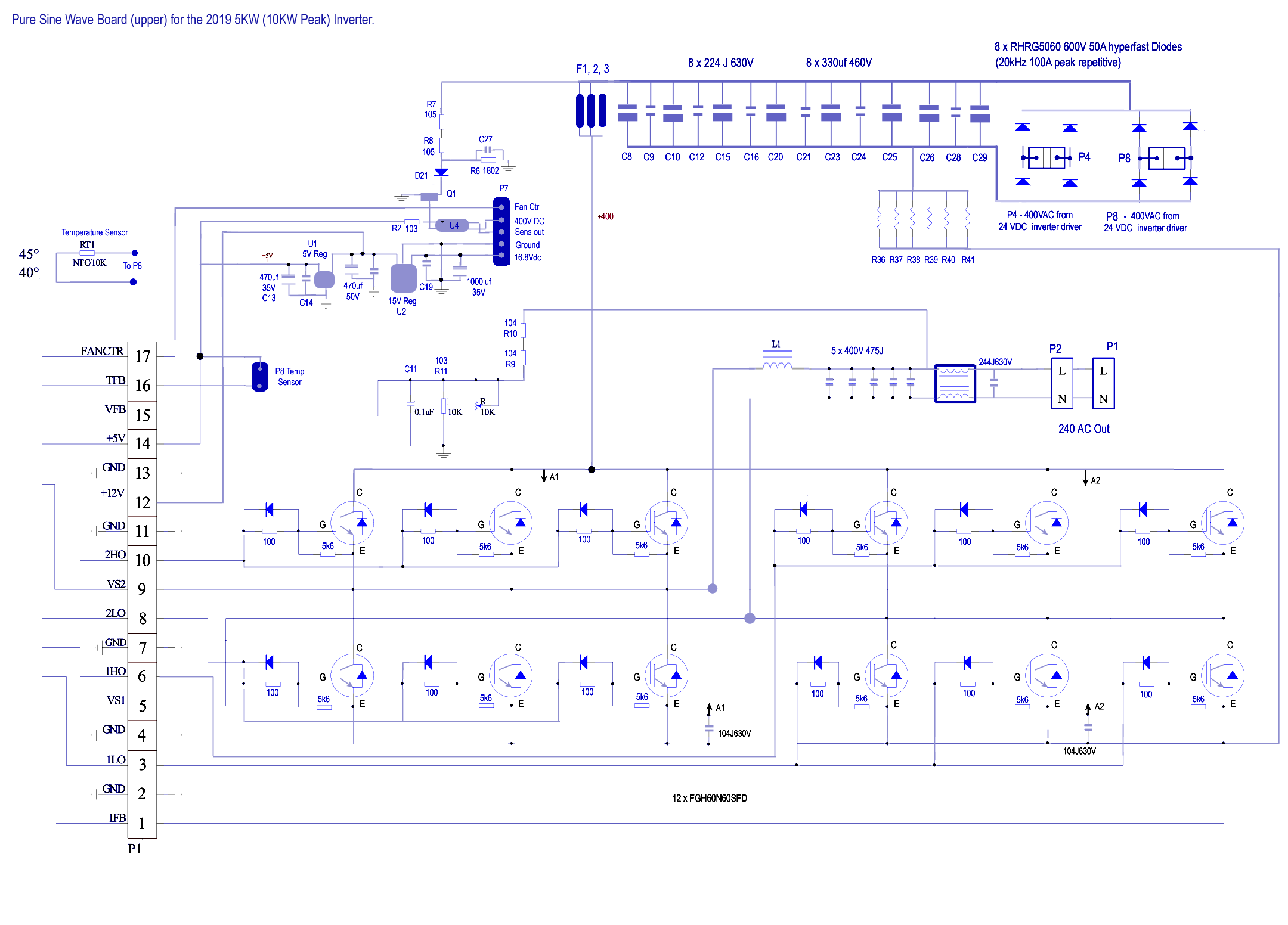

Posted: 06:07am 26 May 2024
Nice work getting it to this stage, I though this might be of some interest to you.
I reverse engineered this circuit for a 5KW continuous 10KW peak inverter:
The important thing: The input is over 390V DC and output is 240V AC.
Obviously, inputs P4 and P8, diodes and all the capacitors after that are to rectify and smooth the output from a Low voltage battery DC input to High voltage AC to power the Sine wave AC output stage.
It might be of no interest, but it's using an 8010 board to drive it. It is a powerful inverter. I might still have a picture of the Chokes used if you are interested. Could not post pix as reducing size makes it very hard to read.
Link to png file
