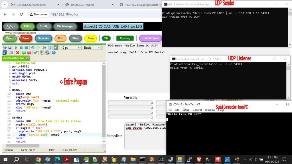

Looking to renew heartbreak? Yes, I've gotten them to work--maybe even a dozen. Not worth the pain--especially compared to something like Annex32 Basic on an ESP32-S2Mini, flashed from your web browser, and costing only $2.50 each, quantity 4, including shipping.
But the OP apparently wants an ESP-01 in "passthrough" mode, where it just provides access to the CMM2 console. I think there were several posts where someone was successful with this for the CMM2. There are apparently a number of options for ESP-01 firmware, including the stock firmware, for which there is an "AT" command which enables passthrough.

If your use is not commercial, why not use Annex Basic?
Home page: Annex Basic
Web Flasher: Browser-based installer
Forum: https://cicciocb.com/forum
Easy to flash any variety of ESP from your browser. Then when connected, you have a browser-based editor and run/debug environment with a programming language which will be familiar. If all you want to do is send and receive messages, this is easily done with not very many lines of code, and you have the choice of UDP, ESP-Now, MQTT, serial, and email.

You are replacing the entire thing though. IMHO the best way is to create that software link that allows a new ESP8266-01S to work as a MMBasic peripheral just as it comes, out of the box. If you have to reprogram it you've lost all compatibility instantly.

Anyone who has actually used the AT commands in the original firmware is likely to appreciate the vastly greater power and convenience of other ESP firmware. If you flash something like ESP-Link, you've got immediate pass-through (after you set up the wifi--just as you have to do with AT commands with the original firmware).
In addition, you may well get "original" firmware which is very much outdated compared to the most recent "AT"-based firmware.
