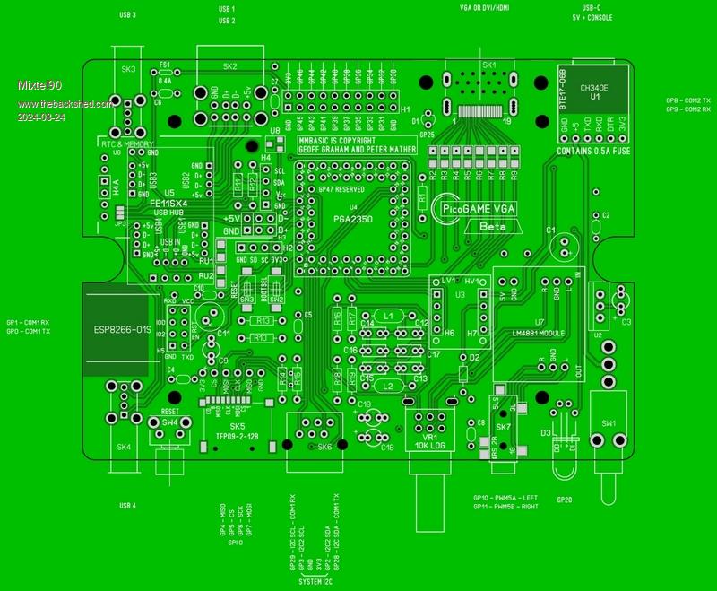

I'm intending to attempt to keep to this thread for my general designs. The more way out stuff might creep elsewhere sometimes. :)
Here's what I have in mind for the first official one. I've called it the Beta because the original Alpha won't work from the published gerbers - the HDMI connector pads are covered in solder resist! When I get the boards I'll try to build one up anyway as I have a Pico 2 for it. I'll let you know how it goes.
beta circuit.pdf
I'm just going over it again, but I think I've found any gotchas. As usual any comments are very welcome at this stage as they are (probably) easy to fix. The enclosure is the little Hammond RM2015S, also known as the MCRM2015S. I considered using the CMM2 box but I find it harder to source and appreciably more expensive. The size isn't *that* much bigger as it's the width that is really the deciding factor.

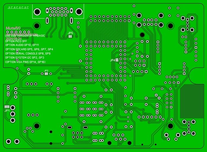

While I was playing I came up with a PCB shape/size that will fit the above case or, by rotating it through 90 degrees, will also fit the square Hammond 1593 box. I've no idea what use it could be though. :) Possibly as a sea-of-holes board?

Hi Mick,
Looks very nice !! Everything you could wish is on it. Audio + amplifier + volume control, video (choice of VGA/HDMI) uSD card, GPIO, game controller interface (RJ12), WIFI (ESP).
The only thing I miss, is a raw 5V at the expansion connector. I would sacrifice GP46 for it (there will still be 16 GPIO pins (30...45) left).
Youmay not need the level shifter between CH340 and RP2350, since RP2350 has 5V tolerant IO's.
Edited 2024-08-24 23:34 by Volhout
Posts: 9383
Posted: 02:02pm 24 Aug 2024
I'm never sure about having 5V on the IO connector. It can be useful but, if your IO isn't 5V tolerant, it can get expensive very quickly!
The maximum tolerated voltage on the GPIO pins depends on how IOVDD is connected. It has to be connected to 3V3 for them to handle 5V5. At the moment I've no idea what they've done on the PGA2350 as the schematic hasn't been published. By default the limit is 3.63V. Pimorini say "Input voltage range 3V - 5.5V (on VB pin only)".
Anyone spotted the deliberate mistake yet? Yes, I screwed up the connections to the HDMI socket. Fixed that one now.
Pin 4 of the IO port is now labelled AUX. It is connected to JP6 beneath the board and by default it is linked to GP46. Changing the blob will switch it to +5V instead.
Edited 2024-08-25 00:15 by Mixtel90

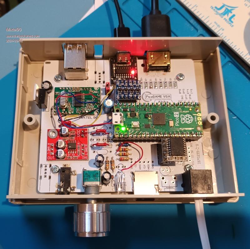

Posted: 01:12pm 29 Aug 2024
Link to my efforts at soldering a DVD connector. :)
It isn't easy, but it's possible.
Here
Have just installed the firmware and I now have a working DVI/HDMI 315MHz Pico 2 on an Alpha board. As this part of the board hasn't appreciably changed on the subsequent versions there's a very high probability that it will work on those too. I'm using 220R 0805 resistors instead of 270R 1206 but that's all I had. :)
SD card is the next stage then I'll probably start to look at USB.
SD card working. They work better when you remember to install the supply resistor...

Posted: 07:37am 02 Sep 2024
Alpha is now up and running!
The audio filter is a kludge as I'm waiting for components.
The second port of the I2C connector can't be used (it's on GP8/GP9 and needs moving)
The supply to the USB hub needs a proper connection instead of patch wires.
There are several missing caps
The Reset button is missing (I have one somewhere)
THe vertical USB sockets are missing (on order).
The ESP8266 hasn't been implemented (and it's on GP8/GP9 again)
The headphone amp has too much gain (X7) but there's little I can do about that apart from limit its input as the gain setting resistors are tiny SMD ones that I can't ask people to change.
The LED has red/green reversed! Oh well, never mind eh? :)
The logo refers to PicoMite VGA!
But apart from those items it's working fine. :)
I'm tweaking the designs for Beta and Gamma to fix a few bits that I've discovered while working on this. Hopefully I'll have them ready pretty soon now.

Posted: 07:53am 07 Sep 2024
Quick update. This is still progressing.
I've now got the proper audio filter in, which has meant doing some track rearrangement in order to handle mylar caps more easily, they can be a bit bulky. Need to trim the pot series resistors. I wish there was a simple way to change the headphone amp gain. I need it because it's doing impedance conversion to drive the headphones. Unity gain might be ok, or possibly x2. x8 is too high.
Additional components added to the HDMI socket. It's now similar to the Olimex circuit except that there are no additional data connections to the Pico. 5V at 100mA is there. I didn't modify Alpha, just Beta & Gamma.
Reset button fitted. Things like this may seem insignificant but it's important in that it proves that my SL6 macros are correct and that I can depend on them. The double USB socket was a case in point. The pins are spaced at 2.5mm,2.0mm,2.5mm distances. Don't ask me why they aren't equidistant. It caught me out.
Quite a bit of experimentation with the best way to disconnect the USB port while loading MMBasic. It really does need to be disconnected, I thought I'd got away with it. I'm still uncertain about cutting down a micro USB lead for the Pico 2. I think I'm going to have to specify a micro USB plug breakout board. Chopping a lead can result in a few 2-core cable ends before you find the right one! It's either that or hard wire the USB to TP2 and TP3 as I'm currently doing.
Some fairly major work was done in increasing the depth of the PCB beyond the maximum size given by Hammond. That left too much of a gap and meant that some components couldn't fit into the front and rear panel holes.
I've been tweaking the manual too, adding component photos.
Discovered what CR1220 batteries are for. You can superglue the holder on top of a clock chip and use it to convert a disposable RTC into one with a changeable battery. :)
