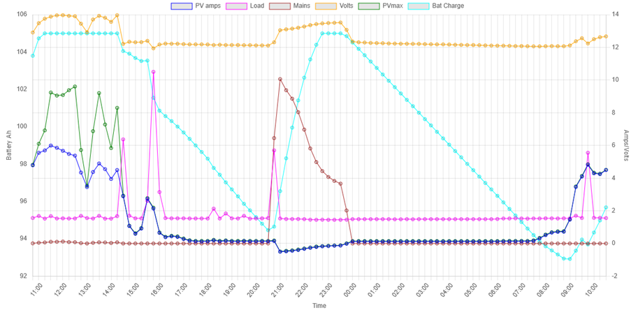

TassyJim![]() Guru Joined: 07/08/2011 Location: AustraliaPosts: 6538 |
Not a caravan but 12V solar with AC backup. I use a combination of current in-out and voltage to estimate state of charge. It took a while to determine the charging efficiency. I am using an INA3221 3 channel current IC module. There is some interference between channels and might have been better with 3 single channel modules instead. ![]() Jim VK7JH MMedit |

| lizby Guru Joined: 17/05/2016 Location: United StatesPosts: 3784 |
Neat graph, Jim. What are the characteristics of your battery? What makes up the near-continuous 1.8A (or so) base load (purple-ish dots) which cause the level discharge between 4:15pm and 8:30pm and again between midnight and 9am? What solar panels are you using? I bought several of the INA3221 modules, but have actually been using the INA226. Can you post your code for the INA3221? Also for the graphing--very nice. (Always happy to be trying to stand on the shoulders of giants.) PicoMite, Armmite F4, SensorKits, MMBasic Hardware, Games, etc. on FOTS |

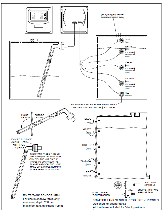

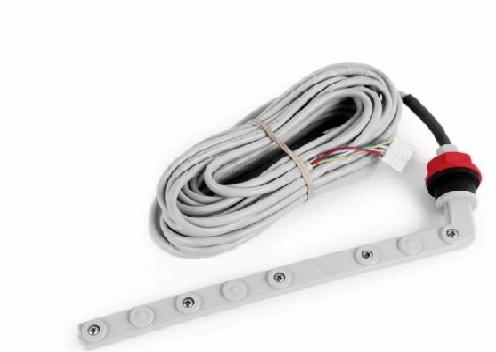

This is what I believe the water tank senders look like. I have not removed one from the tank yet but the connector end looks the same. ![]() Does anyone know how these work? OA47 |
| phil99 Guru Joined: 11/02/2018 Location: AustraliaPosts: 3290 |
Most likely a resistor divider chain between V+ and ⏚ with the top tap connected to the output. The bottom screwhead connected to ⏚ and the other screwheads to taps on the divider chain. The water bridges the submerged taps to ⏚. Should be easy to check with a multimeter. Read it with AIN. Edited 2025-07-30 10:34 by phil99 |
If the sensor is as pictured, it is 5 wires and will need 4 inputs to read. This depicts a number of probes: ![]() I don't know what impedance the probes will be but I expect high and might need conditioning before the 'mite can read reliably. My guess is simple exposed stainless probes relying on water continuity. I remember my caravan sensors were unreliable at best. Jim VK7JH MMedit |

Battery is 2 x 105Ah AGM 200W 12V panel. Most of the load is a radio repeater base station. Also 2 RPi for radio internet linking and weather station. Add a couple of 'mites hanging of the RPi and a network AP to talk to the car charger. The charts are produced by a js library chart.js It is too big to host on a picomite (300k) so I run my data web server on a RPi5. This contains the INA functions: RTV_bat_mon_F4.zip Jim VK7JH MMedit |
