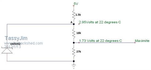

Pete
This is my circuit
I have put a 0.01uF capacitor from point A to ground on some of the long leads.
To get the scaling factors, I measured the Maximite voltage at a known temperature and calculated it from there.

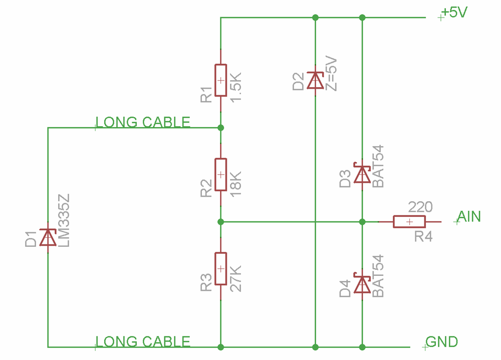

for industrial environment with lot of noise and long cable I would modify TassyJim schematic to this:
I've seen hundreds of volts induced picups on long cables going near motors and relays

Okay, I will add resistors R2 & R3 and recalculate based on the resistors true resistance as measured using a meter.
I'm currently using 1.8K resistors for R1. Do I need to change them for 1.5K resistors or can I leave them as 1.8K? Will these 1.8K resistors affect the voltage divider formula? I don't see how they would, but I am not schooled in these matters.
The formula I will use to calculate the Pin(1) multiplyer is: 100/(R3/(R2+R3))
If R2 is 18K and R3 is 27K the result should be about 166.7, but should be adjusted for the actual values of the resistors. If I understand correctly then the degree Celsius reading would be Pin(1)*166.7-273.
Some of this was taken from Olimex's blog and repeated here for the benefit of those who didn't follow the link. Thank you Olimex
So folks, do I need to swap the R1 1.8K resistors for 1.5K resistors?

The ratio of R2 & R3 will only move the readings a little if you measure the resistors carefully. Worth doing, but it's not going to fix the problem where the temp jumps.
I can't see changing R1 by a little being a fix, either.
You have noise spikes or something (by way of example, a heat source you've not realised is there).
The filters & noise suppression shown in the above circuit and mentioned in various posts are to get rid of (suppress) the noise - if it's noise, and likely it is.

The difference between 1.5k and 1.8k for R1 is insignificant.
It will change the current through the 335Z slightly but not enough to change the voltage output.
Also, small changes in the 5V supply wouldn't make much difference.
The LM335Z output changes slowly by design so any sudden changes in voltage are caused by interference etc.
Eliminate the fluctuations first then worry about getting the true value.
