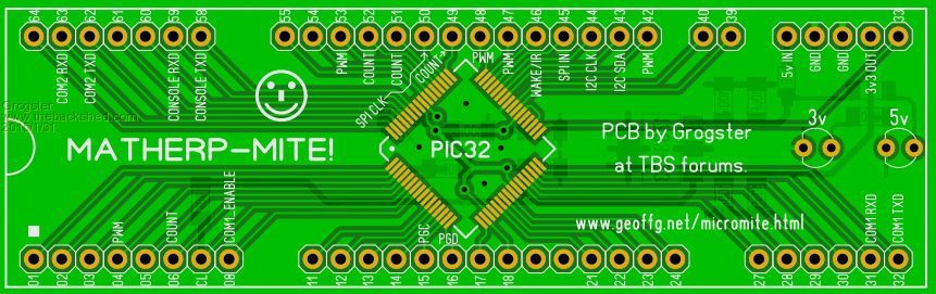

I am about to design a PCB for this module, coupled to the 44-pin uM chip, seduced mainly by the video that matherp linked to in post #4.
The TFT module would mount directly onto a uM carrier PCB, with the idea being that a generic controller code could be designed so that commands sent via I2C or serial, could then control the screen, and feedback from the TFT could be processed and sent back by way of I2C or serial. The uM essentially becomes a glorified screen and touch controller, and that would be it's main task.
I favour serial, just cos of the fact that there are RXD and TXD buffers by default - can't remember if there are such buffers with I2C. Also, using COM1, we could have VERY fast serial control commands and touch responses if we ran at 230k baud.(not that this is really needed, as the 44-pin uM would do all the hard work, really.)
Is this a PCB that people would want?
I have ordered a couple of those TFT panels linked to by matherp in post #1, but I am still having a bit of trouble trying to decipher the code to drive the screen.
God bless matherp's Cfunctions - he the master(and da man!) with these screen driving routines.....

Go for it; such a module would be useful (and gets one of my things off my 'to-do'list
Recommend a single PCB with the TFT mounted as close as possible to the PCB to keep the resulting module as THIN as possible.
Also keep it to within similar proportions with just four mounting holes accessible.
COM should be good enough but why not SPI/I2C as well?

Posts: 9975
Posted: 10:13pm 27 Jan 2015
I2C fine, but the SPI is used by the touch side of the panel. I only see one SPI channel on the uM - even the 44's.
...unless I missed something, which would not be the first time...
As to dimensions, I would like it to piggy-back DIRECTLY onto the TFT module PCB, using the same exact mounting holes. You would then mount both the TFT module AND the carrier uM board using the same four bolts, and spacers - that's the plan anyway.
EDIT: From post #2:
  matherp said  The pinout avoids i2c, and comm1 pins and uses SPI for the touch input. However, the 2046 has a proper chip select so can share SPI with other devices.
With that in mind, I guess that SPI control is also possible on the same bus then, but not sure it would jive in this context - the touch controller would need to grab the bus with the CS line while anyone is touching the screen, which would mean that incoming commands on the SPI line would be ignored until the user moves their finger away, would it not?
