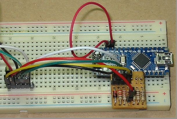

A pic of my Nano PIC32 programmer and patented veroboard addition :) The 5 programming pins are available on the top headers, while the bottom header plugs into the breadboard.
Turns out the Nano PIC32 programmer is more than twice as fast as a PICkit2 using pic32prog!

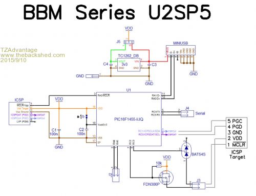

MicroBlocks
Joined: 12/05/2012
Location: Thailand
Posts: 2209
Posted: 05:05am 10 Sep 2015
@Rob,
I have looked at the schematic for the nano and it looks pretty simple.
Also the code that runs on the nano is well documented.
I would like to investigate the possibility to extend the capabilities of my current USB-Serial 'block' to be able to act as a programmer instead of the nano.
Reading the source it is stated that pins D2, D3 and D4 are used as Open Collector outputs.
In the datasheet (page 4 point 1.1.6) of the 328 however it looks like those pins are not open collector capable but are of the push-pull kind.
Is this an error in the documentation? Or am i overlooking something and the pins can be set into a open collector mode.
I suspect that the pins are used in a normal output mode but only when the output is a logic '0'. When a logic '1' is needed then the pin goes to input mode and is high impedance. To simulate a Open Collector output. Would that be the case?
To make the hardware more safe i could add a schottky diode.
A mosfet to enable/disable power to the target would also be possible to add to the circuit if i can find one that is small enough. :) The user can determine if it is 5v or 3.3v with a jumper.
EDIT: I changed my schematics with what would be needed to be able to use it as a programmer. What do you think?
Edited by TZAdvantage 2015-09-11
Posts: 2552
Posted: 02:06pm 10 Sep 2015
TZadvantage: you are indeed correct, the 'open collector' effect is achieved by switching the pins between output and input mode. in every sense this is quite real, as the high-side transistor is always off, while the low-side one is toggled.
the crude method of delivering power to the target (3x 100r resistors and a 3v3 zener) was used in the interests of simplicity. a mosfet is a tidier solution, but i didn't use one because of cost and complexity. i had also considered a 3-terminal regulator, but a zener was cheaper and the 50mA standing current draw was inconsequential. i spread the load across 3 output pins with balancing resistors to keep below 20mA/pin.
do be aware that the (master) source repository at:
https://github.com/sergev/pic32prog
is lagging behind my one:
https://github.com/robert-rozee/pic32prog
the main difference being that serge's version is still running the serial connection at 500k baud, while mine has it throttled back to 115k2 along with extensions to handle 4-bit/symbol encoding. i am just waiting for serge to update his (master) branch.
since you are using a single device for both USB bridge and programmer, the serial speed difference probably doesn't matter, but the 4-bit extensions will. however, they are backwards compatible.
you may need to add a configuration jumper to your design to select the 'ascii ICSP' mode. this jumper could be inline with the pin 7 output - you could then sense the presence of the current 10k pullup to Vdd as indicating the need to enter 'ascii ICSP' mode instead of 'serial bridge' mode.
i do like your idea, and fully support it
rob :-)

  robert.rozee said   since you are using a single device for both USB bridge and programmer, the serial speed difference probably doesn't matter, but the 4-bit extensions will. however, they are backwards compatible.
Actually I think it will matter.
In my initial tests with the 16f1455 I was starting to get communications errors on speeds above 115200 Baud.
It may be possible to get higher by adding a xtal but if your code is set to 115200 and we know that the 16F1455 is reaching the limit above that rate, I would say they are a good match.
Chris

Did you ever do programming of other ranges of PICs?
The newer PIC16F among many for instance allow programming at VCC voltages.
Are the hardware ruiguirements the same for these as the pic32mx series.
If it is then a whole other range of pic could be programmed using the same hardware.
