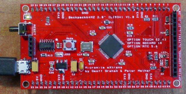

64-pin
Features:
PIC16F1455 USB/UART and PIC32 programmer
All pins broken out on a breadboard compatible 0.1" grid
Direct mount for 2.8" ILI9341 display including SDcard connection
Optional PWM control of display backlight
Gerbers
2017-03-20_092558_backpack64MZ.zip
Schematic
2017-03-20_092620_Schematic.pdf

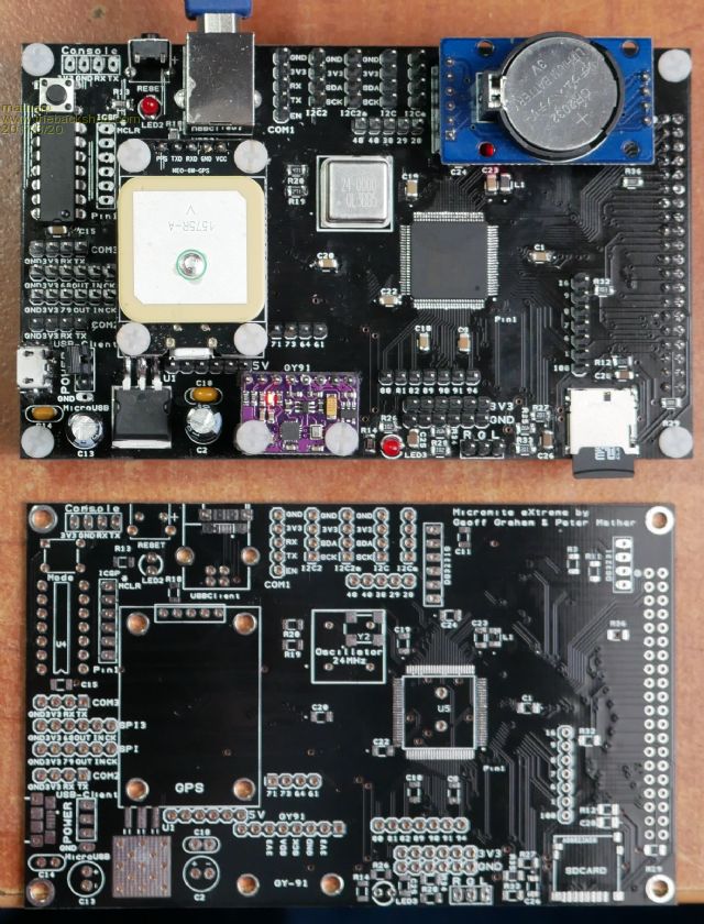

100-pin: Type 1
Features:
All pins broken out
Function specific headers for COM, SPI and I2C ports
GPS header
GY-91 header
RTC header
Direct mount for 4.3" SSD1963 display
Micro SDcard slot
Onboard line-level sound output circuitry
6-off each pins to supply GND, 5V and 3.3V for additional circuitry
Gerbers
2017-03-20_093120_Backpack100min.zip
Schematic
2017-03-20_093141_Schematic.pdf

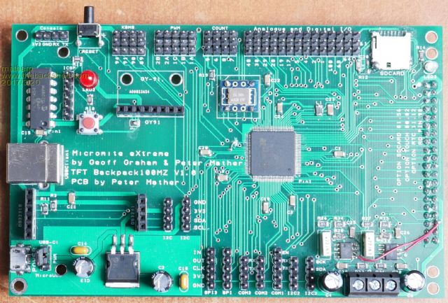

100-pin: Type 2
NB:
The picture shows the first prototype which has a few faults (wire links in picture). These are corrected in the attached gerbers but the revised version has not been fabricated at this point
Features:
All pins broken out
Function specific headers for COM, SPI, COUNT, Keyboard, mouse and I2C ports
PWM ports arranged for direct connection of servos with 5V supply
GY-91 header
RTC header
Direct mount for 5" and 4.3" SSD1963 displays
Micro SDcard slot
Onboard sound output circuitry with audio amplifiers for direct speaker connection
14-pin header for additional analogue and digital I/O with 14 each 3.3V and GND connections
Gerbers
2017-03-20_095340_Backpack100.zip
Schematic
2017-03-20_095022_Schematic.pdf

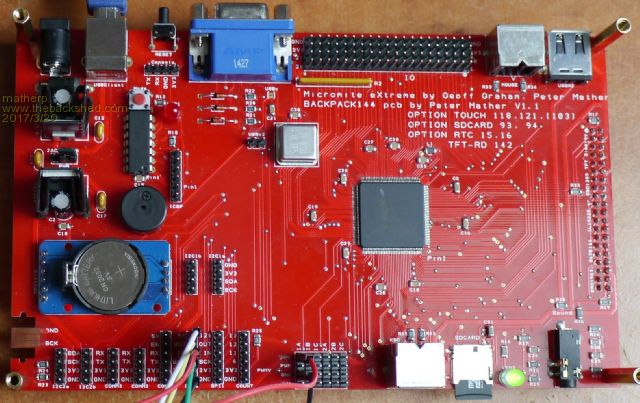

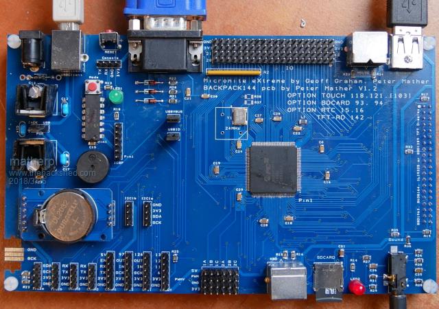

144-pin
Function specific headers for COM, COUNT, SPI and I2C ports
40-pin header for addition Analogue and digital I/O with 20 each 3.3V and GND pins
Onboard pullups for 8 I/O pins allowing direct connection of DS18B20 etc.
NunChuck Connection
PS2 Keyboard port
PS2 Mouse port
RTC header
Direct mount for 7" SSD1963 display
Micro SDcard slot
Direct PIC32 USB connection
VGA monitor port
Onboard line-level sound output circuitry with audio jack socket
Gerbers
2017-03-20_100754_Backpack144.zip
Schematic
2017-03-20_100824_schematic.pdf
