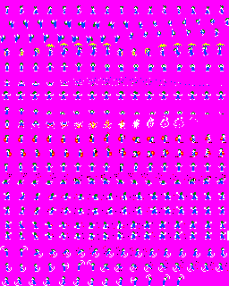

Posted: 08:06am
15 Aug 2026
Martin H.
I’ve put together the complete set for you here as sprites and CSUB file. These are 318 converted Amiga sprites which, to allow for freedom of movement, are still 16x16 pixels in size.
sprites.zip
You can, of course, create a Lib from it or read the BMP using BLIT FLASH. See which works best for you.
Have a good Weekend
Martin
