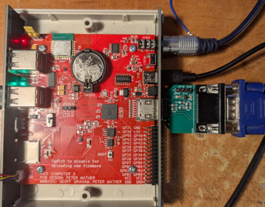

Here is an update to the HDMIUSB board
SCH_Schematic1_2026-06-13.pdf
This is configured using OPTION RESET PICO COMPUTER 3 with the 6.03.00 firmware (RC18 onwards. This configuration applies to every RP2350 build. In the case of VGA builds you can use a little PCB adapter to connect to the I/O port.
In the case of the WEB and bluetooth builds it uses the official Raspberry Pi RM2 (RMC20452T) wireless module which effectively makes the board a super RP2350B Pico2-W
I've been using a first prototype to test the new HDMIWEB build and all looks good. Note that I've simplified the DVDD supply by using a fixed 1.3V regulator which works perfectly up-to 396MHz and the board now includes a 4 Pin JST-SH Cable (Qwiic, STEMMA QT, Qw/ST) connector to allow modules to be chained off it if required. I've also replaced the p-channel mosfet which switched the USB host 5V rails with a proper higher power but current limiting switch.
As before the board provides I2S audio has a DS3231 RTC and all the usual goodies. I'm waiting on a second prototype that has a trivial pin usage change and assuming all good will then release the gerbers. Cost for a board fully populated other then the RM2 module (JLC/LCSC don't yet stock it, but they did do the PCB layout for me) is about USD45 each in 5-off quantity

The RM2 is solderable by hand. The pads extend a bit beyond the outline of the device and it has solder pad cutouts like the Pico. However, the easy way is a bit of solder paste and a heatgun - all done in 10 seconds

The boards are in and everything works perfectly
Gerbers, schematic and design files
Pico Computer 3 2026-06-25.zip
Cost for 5 boards fully built is just under USD180 + any applicable tax and shipping. You can save money by soldering headers etc. yourself. I bought them without headers, flash, RTC, PSRAM and UART chips and cannibalised old boards for these, that brought the price under USD100. JLC don't stock the wireless module but it is available from Pimoroni amongst other places. Of course, it isn't needed for the board to work with one of the non-Web firmware builds. It can run any of the RP2350 firmware builds and you can use OPTION RESET PICO COMPUTER 3 to configure it.
I have 3 spares available for GBP40 for anyone in the UK who wants one - PM me if interested. GBP44 if you want the wireless module included.

The HDMI/VGA adapters have arrived from JLC. I just got the board made up by JLC with the SMD resistors - with a discount token this cost me USD8 including tax and shipping!. I then bought the Male HDMI connector from LCSC. This mounts to both sides of the PCB but is really easy to solder as the pin spacing is effectively twice that of a normal HDMI connector (flat side up), the VGA connector and headers I already had in stock. This means I can test or use every RP2350 build with the same main Pico Computer 3 PCB and this adapter    OPTION RESET PICO COMPUTER 3, OPTION VGA PINS GP12, GP14
Schematic, design file, gerbers etc
HDMI USB Adapter_2026-06-26.zip
