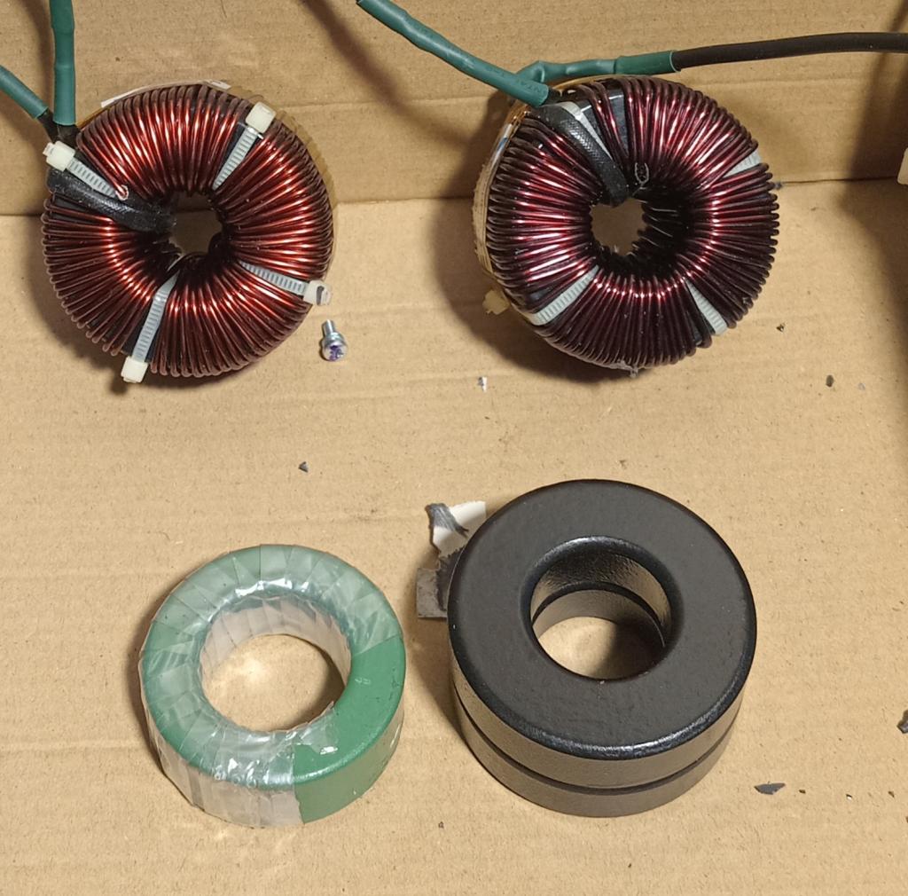

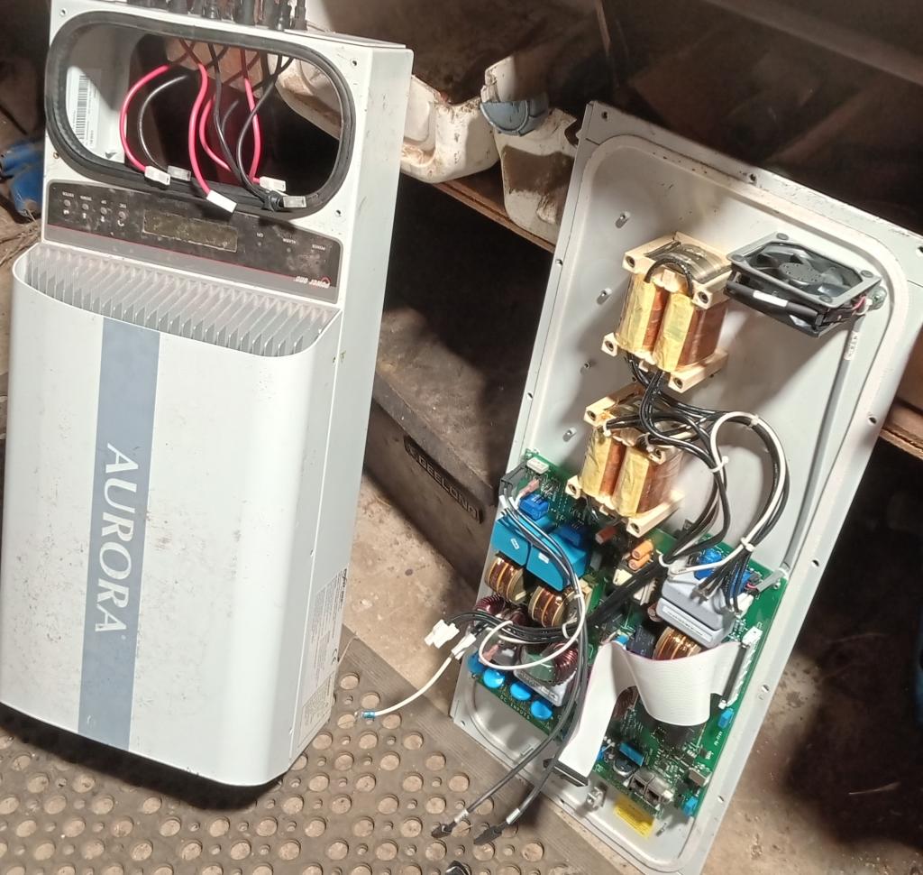

I scrapped a 5 kW Aurora inverter and found these transformer cores, they look amazingly similar to the required design specs. Is it ok to mix and match to come up with the required chokes? Since it falls slightly short of twelve of the black ones - am thinking to stack them as two sets of 4 x black + 2 x green.
Black: 57x27x15 OD/ID/Width in mm, weight 182 g Quantity: 8
Green: 49x29x19, 123 g Quantity: 4
Posted: 01:59am
16 May 2026
KeepIS
The black cores may be OK, most of the usable cores I've removed from old inverters have had a code number on the sides, if not, then the only way to know for sure is to use a Saturation tester to check them.
Not knowing what test gear you have available makes it hard to suggest options, for example, if you have a way to measure the inductance of 4 cores with 6 turns of cable, it might give us an idea of the type of cores they are.
But the black cores look promising, green would need to be checked, it usually indicates a different material mix.
I have mixed cores to get the required inductance, so no problem, but the Mixed cores had "similar" saturation profiles and material mix.

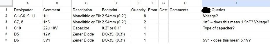

Could we also please get clarification on the minor queries in lines 2, 3, 4 & 6 in image below? From our working list for BOM '5KW FET Power PCB WG30Rev3 Issue 070225'.
Posted: 02:11am
16 May 2026
KeepIS
2: likely 100v will have to check when I get home.
3: Yes 1n5 is 1.5nF
4: Tantalum or Solid.
6: Yes 5.1V
They are written this way as the dot in 1.2k can be missed or faded, but 1k2 it cannot.

I got blue cores from the 5K Aurora  see here https://www.thebackshed.com/forum/ViewTopic.php?TID=10343&P=8
And those Copper sheet wound chokes are good for a charge controller no need to scrap them.

I did get some good blue cores out of a Solis inverter, but couldn't read the part no's . Usually the sendust ones we want are blue or black. The green is more usually used for line filters on the d.c. inputs or 50Hz ac outputs and likely would not be suitable.
