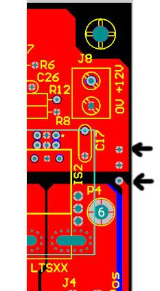

Build notes #2:
Previous notes: here
Something not discussed here much, if at all, is the important design detail Wiseguy made in the board. This thing is an attempt to isolate the noisy power and switching ground from the sensor's outputs. We need to make a link, connecting 2 holes, to join the sensor ground to the switched power ground. We also need to put a ferrite bead in the link as well.
The two pads we need to link:
I would use any ferrite bead I can find, and link it with any copper wire you have easy access to.
Next is the thermistors. I would prefer if we all choose to have the thermistors connected to 5V on the board. And on the brainboard we make a link to pull the thermistor output down to ground.
on the power board, one of two locations, use the two pads inside the rectangle:
on the brainboard:

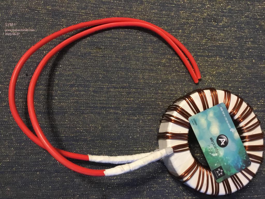

I haven’t got the boards yet but I have a micromite to produce a PWM waveform and a DCOI gate drive circuit good for up to 70V or so.  It seems OK at 20khz.  I have cobbled together a simple dc to dc converter to test the inductor.  I am picking up about 30V from 9 or 10 Lifepo4 batteries (200ah) and dumping the power into 8 of the same batteries.  No capacitor.
I have about 12 turns of twin speaker wire on the inductor and I can get up to about 25A to flow by gradually decreasing the mark space ratio.  After that things go wrong suddenly.  I am using 4115 fets rated at about 150V. 104A with 6mOhm on resistance.  After the 25A point I go straight to 50A flowing - either my 40A fuse blows or the FET dies.
Should I use fewer turns (say half)  to reduce the Ampere turns?  Or do I need to add 2 more cores?
Also when I increase the input voltage (by adding in more cells) I get worse control.
Sorry I can’t measure the inductance.
Ah ha - I have now read the pdf referenced above and I conclude:
I have 2 5.2” type 2 torroid cores.  It should be a T520-2 so have an AL of 20 so that gives me 200uH per 100 turns so to get the required 100uH I need 50 turns.
But I am just a blind man stumbling around in the dark.
Edited 2020-06-27 13:52 by SYM-1

If you have one T520-2 core the Al is 20 nanohenries for one turn.
Inductance is proportional to turns squared.
So 20nH x 71 turns x 71 turns = 100,820nH  = 100.8uH
If you stack two of those T520-2 cores together.
40nH x 50 turns x 50 turns = 100uH
H (Orsteads) = 0.4 Pi x 50 turns x 50 amps divided by magnetic path length 33.1 cm.
1.2568 x 2500 ampere turns / 33.1 = 95 Orsteads.
(see the curve and formula on page 18)
At 95 Orsteads (50 amps and 50 turns) that monster is not even anywhere near saturation.
Even at 200 Orsteads (100 amps and 50 turns) it still has 98% of its original inductance 98uH !!
Stacking two cores produces twice the inductance, but it will still saturate at the same current as one core would. They both saturate together at the same point.
One core is probably more than sufficient, and extra turns above 71, and/or two cores will make a very worthwhile reduction in ripple current.
Turns squared is a very powerful factor for increasing the inductance.

SYM-1
Thanks for that Tony.  That makes things a bit clearer.  This is the core with 20 turns on it.   I guess I need a few more.  It already has 18W I2R losses.  With 2 1/2 times as many windings I might need bigger wire (current windings are 3x 2.3mm dia).
