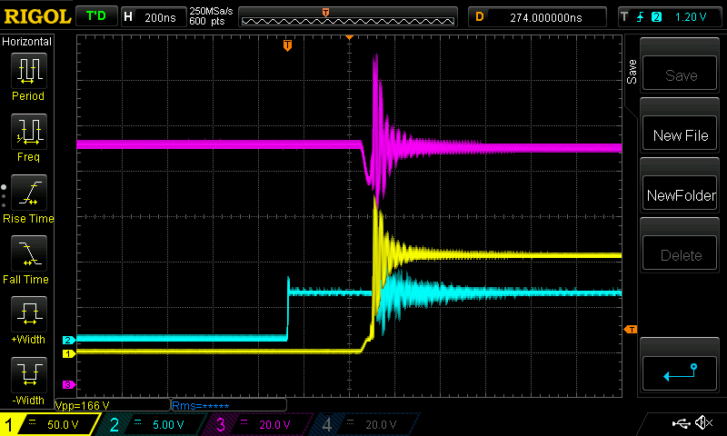

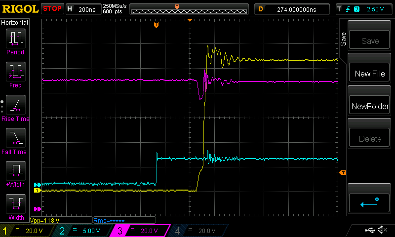

The 200V 60A diodes arrived.
They are STTH6002CW dual diodes with the center pin being the cathode.
I will compare them with the HY5110 as a diode.
103.5V input, 1800W output into 45V
Without a 0.5nF/10 Ohm snubber from switch node to DC + input
and without it.
Yellow is switch node voltage
Purple is DC input
Light Blue is pwm control into the TLP250
First we see no snubber and HY5110-as-didodes
not too bad at all.

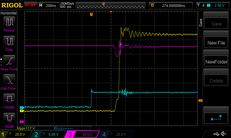

Now with the RC snubber

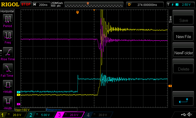

I retained the snubber and installed the
Now that is unexpected. I thought it would be a smaller spike, and not
very long lived oscillation. This is not very good.
Last is the Yellow trace re-scaled to 50V/div
And it combines many traces so we can see the sort of average behavior
of this thing.
peak voltage exceeds 170V.
Having the HY5110 in place seems to tame this wild voltage oscillation
but probably at the cost of over volting the HY5110 body diode, which goes short circuit for voltages over 118V
I am thinking I will stick with the HY5110-as-diodes and of course use
the nice FDH055N15A MOSFETS for the switching job.
I won't bother doing this test on Wiseguy's power board, I expect near identical
results.

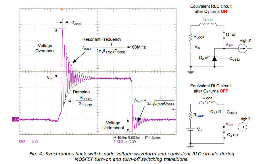

I find the 170V oscillations disturbing.  Sure the HY5110-as-diodes may solve the problem but can they take the stress long term?
It seems to me there is a stray inductance problem that is begging to be discovered and solved.

here are two pdfs I find most educational on ringing.
H2PToday1803_design_TexasInstruments_Part 3.pdf
and a practical worked example
AN045_EN.pdf
here are the gory details:
Coss2 is the diode capacitance. I suspect the HY5110 has a lot more
and so when in circuit the ring frequency is a lot lower.
But maybe the Q factor is lower so it does not ring so much.

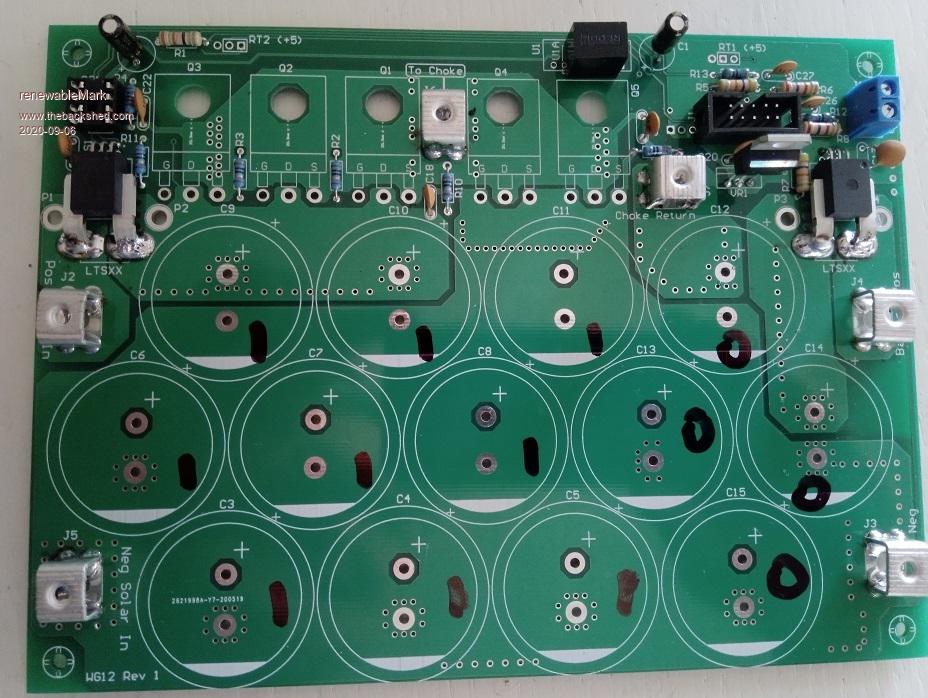

Peter, on P10 you said to use 9x 450uf on the input and 5 x 450 uf on the output.
But these boards have 4 on the output.
If I use the 470 uf I have it will be 1880uf compared to 2250 that you had.
Will that do?
Posted: 07:43am
06 Sep 2020
poida
Mark:
not to worry. This project will work with just about any reasonable
collection of caps. No need to be exact.
I would fit 4 caps to the output.
The first board I built ended up donating all it's caps to the Wiseguy board build.
And so I thought, what could I get away with if I took an attitude of
"let's be stupid" when fitting caps?
So this board has 1 x 540 and 1 x 450uF on the input.
And 1 x 10,000 uF on the output.
And the firmware still works fine when driving the 1 Ohm load.
I suspect it will be also great when driving a proper sized battery.

Mark, where did you obtain the screw terminal connectors ? I ordered mine from Ali nearly 3 months ago and still waiting.....
I am getting close to having an MPPT test bed finished. I used a normal diode as the flywheel part and a 30V supply it all worked well.  Then I inserted a HY4008 as the lower diode which also started out working well, but applying a very low R load to the output immediately killed the HY4008 dead as a dodo. First FET I've killed in ages.
I am confident that a diode would not have died & I must admit that with the gate tied solidly to the source, and the Drain Source diode being reverse biased I dont understand the mechanism that killed it. So I will investigate this further with some other disposable FETs and try to figure out why is it so.
I have also had a bit of a play with snubbers and will take some screen shots of over, under and critically set up snubbers and how to select values for them.

Mike I got them from ali. I have some spare I could stick in an overnight bag, considering how sh*t oz post is currently you may get them in a couple of weeks.
yell out if you want them, I think there is enough for one more board, there are more on order.
