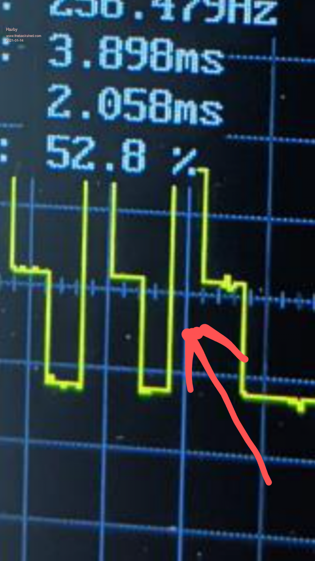

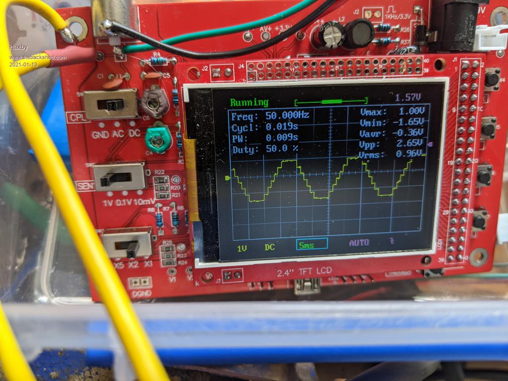

Could the toroid cores have become permanently magnetised?
Here was the working trace with 2 inverters, no load, 140vdc. I can see an offset from zero. Is that a clue?...

Posted: 03:28am
13 Jan 2021
Ah yes, that inverse diode is extremely important.
That last waveform looks o/k.
Don't worry about the ragged looking steps, they always look like that until you have all four inverters going.
The reason being, that the transformers are trying to switch a current that is stepping up and down.  Inductive components don't like instantly changing current.
When all four inverters are running, the current in all of the transformers will be a nice smoothly changing sine wave.
All four transformers will be very happy, and all the waveforms look a lot cleaner and much nicer.  Its an amazing transformation.
